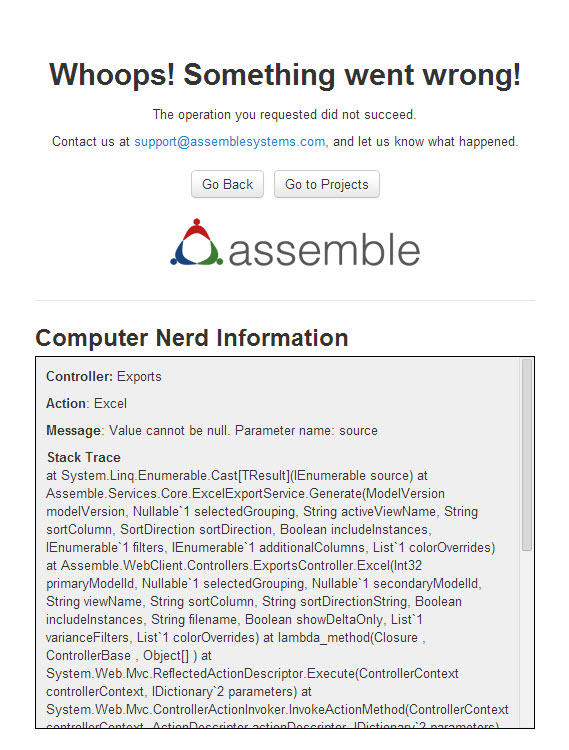

Error: Whoops! Something Went Wrong!
Error message in Assemble: Whoops! Something went wrong!
The error message appears when exporting to Excel or exporting to Navisworks Search Sets while the Assemble Grid is loading information.
For best practice, we recommend waiting until the Grid has finished loading before attempting to export to Excel or Navisworks Search Sets.
If an export option is clicked before the Grid finishes loading, please wait with the Export To window open until the grid finishes loading, and the data will successfully export.
