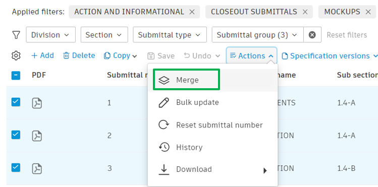

Select the submittals that you'd like to merge.
Click the Actions drop-down menu.

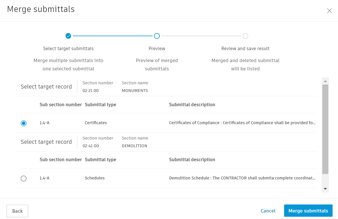

Click Merge. This will open a screen that will allow you to complete the rest of the merging actions.

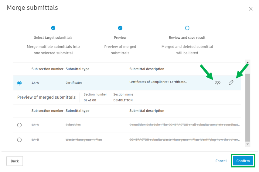

Select the target submittal and click Merge Submittals
Use the View icon to view the submittal description or the Edit icon to edit the description.
Click Confirm.

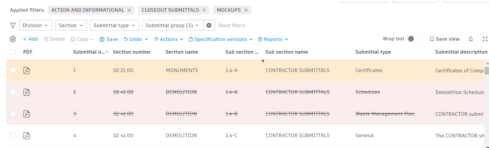

Once you've completed merging the submittal items, the Smart Register tool will be updated. The submittals that were merged appear as deleted, with details crossed out and their rows appearing in red. The target submittal is highlighted in orange.
Click Save to save changes.

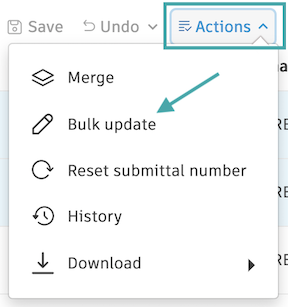

Click the Actions drop-down menu and choose Bulk update.
This will open a set of screens where you can edit submittal details to apply to all selected submittals.

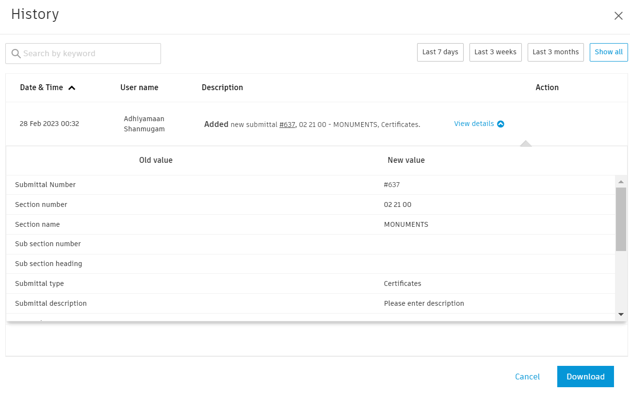

History
You can view and download the history of actions from the Smart Register tool. Actions are visible over the:
- Last 7 days
- Last 3 weeks
- Last 3 months
- All time
To view the history:

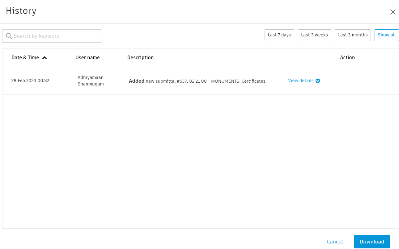

Click the Actions drop-down menu and choose History.
Choose to Show all actions or filter by actions over the Last 7 days, Last 3 weeks, or Last 3 months.
Click View details to see more information about the action. If the action involved deleting information, you can click Revert to undo the deletion.
Click Download to save a local copy of the history in XLS format.
Click Cancel or the
icon to close the history.
