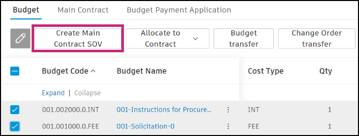

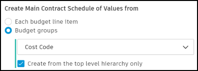

Create the SOV from the Budget Tab
To create the SOV from the Budget tab:
  1. Select the Budget tool from the left navigation.
  2. Select the Budget tab.
  3. Click the icon.
  4. Select the budget items for the main contract.
    Note: Budgets can only be added in batches of 200, so for larger budgets, add them in multiple batches.
  5. Click Create Main Contract SOV.
  6. Select the name of the main contract using the drop-down list.
  7. Use the radio button to bring in either each line item or bring in only certain budget code segments.
    Tip: You can also create from the top-level hierarchy only. The owner can review the budget faster when only the top level of the hierarchy is used for the main contract.
  8. Click Create.
The main contract SOV will now be created automatically and link to the budget. This connection allows members to see what they will be paid and what they need to pay their suppliers.

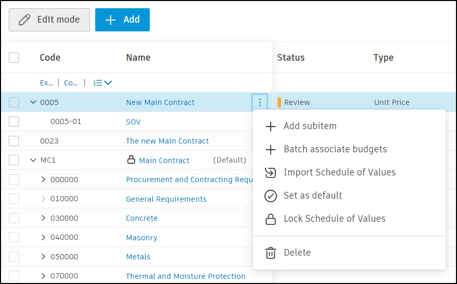

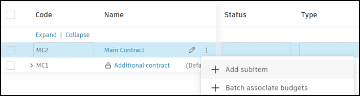

Add or Delete Subitems in the Main Contract
To add subitems to the main contract:
  2. Select the Main Contract tab.
  3. Click the icon.
  4. Select the More menu in the desired row.
  5. Select Add Subitem. A new line will appear under the main contract.
  6. Fill in the required information in the new row, for example, choose the budget code to link a main contract to a budget. Either type in a value or associate it to a budget code by selecting within the budget code column; the value will auto-populate.
After adding the subitems, you may want to toggle the Preserve the Main Contract value option. See the Spread Markup Budget Value in Main Contract SOV section to learn more.
Note: Once a payment application exists, the contract will be locked, and edits can't be made.
To delete the items from the schedule of values, follow the procedure but select Delete.

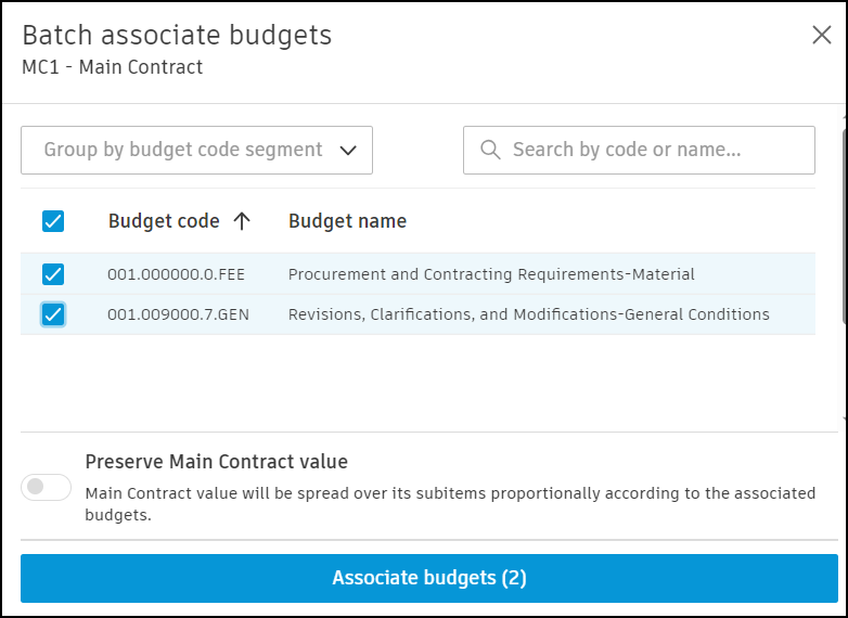

Batch Associate Budgets
The Batch Associate Budgets option is useful when fees are not openly disclosed to the customer and spread over main contract SOV line items. To batch associate budgets to the main contract SOV:
  3. Click the icon.
  4. Click the More menu next to a main contract.
  5. Choose Batch Associate Budgets.
  6. Select budgets. Note that the selection limit is 200.
  7. Selecting from the Batch Associate Budget window means that the original unit cost of the main contract item will be overridden and will show the new selected budget item value. If you do not want this, toggle the Preserve Main Contract value option to spread over its subitems proportionally, according to the associated budgets. See the Spread Markup Budget Value in Main Contract SOV section to learn more.
    Note: If Fixed Price is set as contract type, the setting to preserve main contract value will be toggled on by default. This setting assumes that fee or markups details may not be shared with the owner, so autodistributed markups in change orders to the work line items too.
  8. Click Associate Budgets.

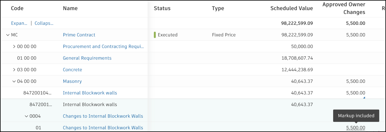

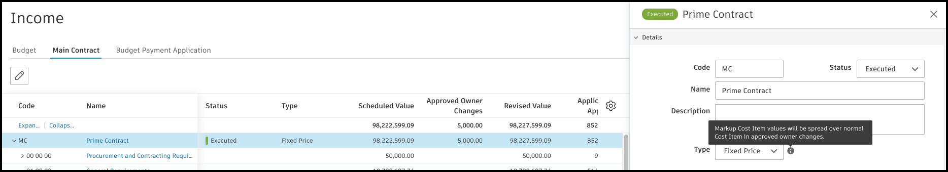

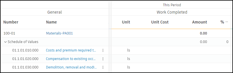

Spread Markup Budget Value in the Main Contract SOV
As a general contractor, you may have an internal budget price and a selling price. In case these two are different, there is an option to track two sets of values within Cost Management. In this scenario, an owner sees the full price with markups included without making them visible from an owner's collaborative perspective.
Once choosing Fixed Price for the main contract's type, you'll gain an option to preserve the main contract value when associating it with a budget. Markup cost item value will be spread to nonmarkup cost items.
You'll find information that a markup is included. If an OCO is added to the main contract before Fixed Price is selected, automatically spread markup after the type is switched to Fixed Price.
An option to choose to preserve the main contract value shows:
From an owner's perspective:
  • The Markup Summary section in the flyout panel is no longer visible.
  • While responding to an OCO or COR, the unit cost is showing as a sum of the amount and spread markup in the Scope of Work section. The markup list is not visible for an owner.
  • Markup cost items and the Markup Summary section are hidden in the budget payment application, and an owner sees the full price with all markups without marking them.

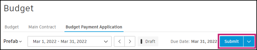

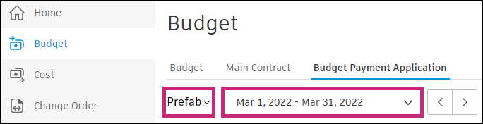

To delete an associated budget payment application:
  2. Switch to the Budget Payment Application tab.
  3. Select a main contract and then a billing period from drop-down lists.
  4. Click Status Change.
  5. Revert the payment application's status to the Draft or Revise and Resubmit.

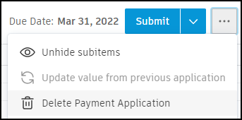

  6. Click the More menu .
  7. Click Delete Payment Application.
  8. Click Delete in the pop-up window.
  9. Repeat the action for every billing period within the payment application connected to the main contract.
