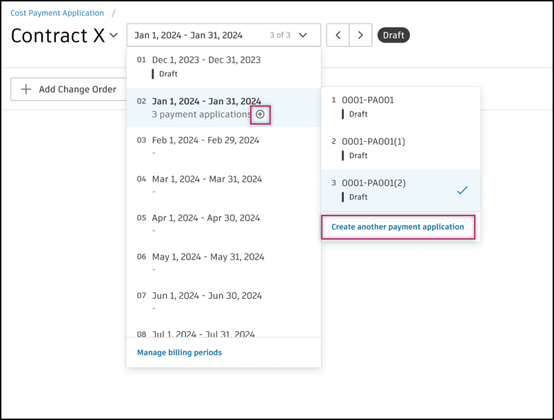

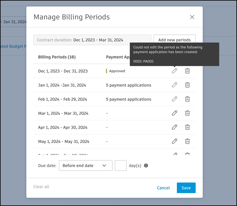

Create Multiple Payment Applications in a Billing Period
Administrators can generate up to five payment applications in a single billing period. This is beneficial in scenarios such as making advanced payments, releasing retention separately, and creating net adjustments retrospectively.
To add multiple pay applications in a period:
  1. Go to Cost Payment Application, select the billing period to which you want to add a payment application.
  2. Select the plus sign within the Manage billing period drop-down or choose Create another payment application in the drop-down submenu.
  3. New payment applications are added at the end and have consecutive numbers provided in parentheses.
Note: The payment applications are calculated based on the time/date order of creation and must be approved in this same order.

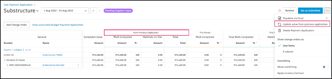

To manage payment applications in a billing period, select Manage billing periods in the drop-down menu. Here, you can rename or delete any application.
Note: If a payment application in the middle of two others is deleted, the member will need to select the Update value from the previous application button to recalculate values.

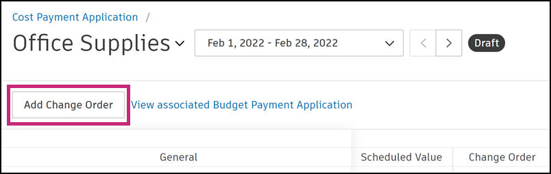

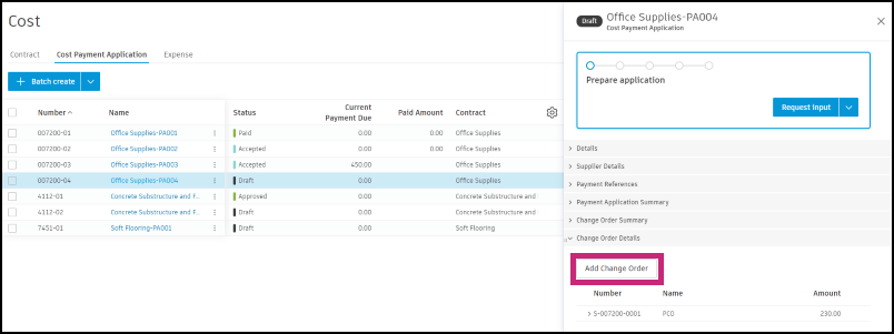

To add change order to cost payment application:
  1. Navigate to the Cost Payment Application tab and open the details view of item you want to add change order to.
  2. Click Add Change Order.

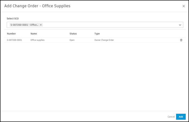

    If there are SCOs available, they will be grouped into Approved and Unapproved sections.
    • The Approved section displays items that have Approved and Executed statuses
    • The Unapproved section displays items that have Open, and In Review statuses
  3. Select the items that you wish to add, and click Add.

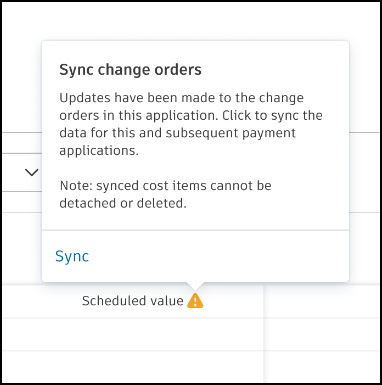

  4. After adding unapproved SCOs, you will be asked to synchronize change orders. To do that, click Sync.
    Note: Synchronized cost items and their subitems cannot be detached or deleted.

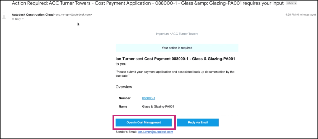

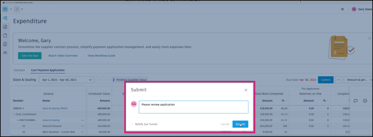

Respond to Cost Payment Application Email as a Supplier
When receiving a cost payment application email, as a supplier:
  1. Open the email and select Open in Cost Management. When Cost Management opens, only the information pertaining to a supplier’s cost payment application will be visible.
  2. Scroll to review details. In the columns within This Period, click the fields to enter the completions. The information will autopopulate based on the Amount or % entered.
  3. To autopopulate data based on the item being 100% complete, select the More menu next to a line item and choose % mark as completed.
  4. Once the payment application information has been populated, select Submit.
  5. Include a message in Submit.

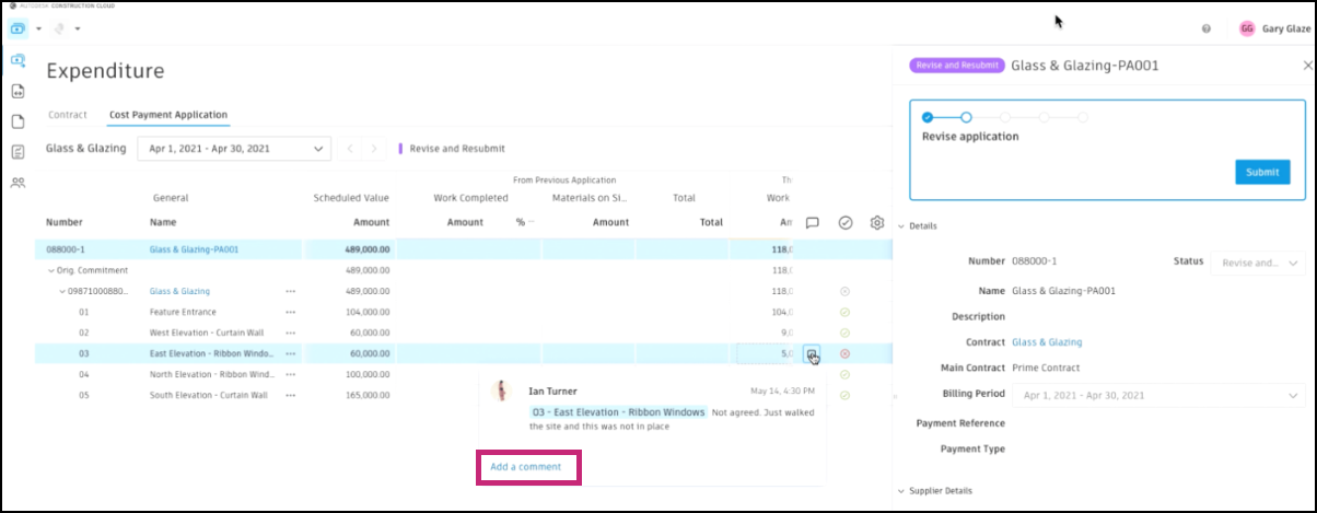

Once submitted, the system will notify a general contractor by email. They can review line-by-line and accept, reject, and leave comments. If a revision is required, they may request it. A supplier can respond directly to the comments left by a general contractor and make necessary updates.
When done, a supplier submits the payment application back to a general contractor. A general contractor can accept all line items. The system will notify a supplier by email.
