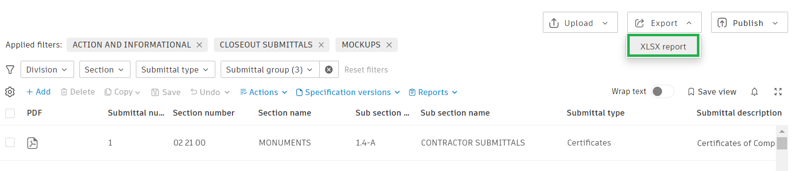

Export Submittal Log
To export an Excel (XLSX) report of your submittal log:
Click Export on the upper right corner of the Smart Register table.
Click XLSX report, and your report will be downloaded to your local device.

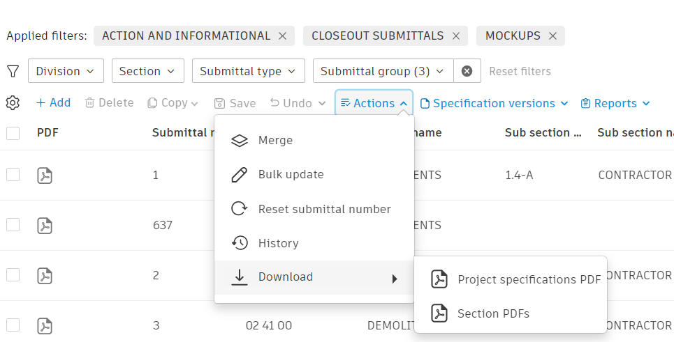

Download Project Specifications and Specification Section PDFs
You can also download project specifications or specification sections as PDF files.
Click Actions.
Hover your cursor over the Download option.
Select either Project Specifications or Specification section PDFs.
Your download will begin automatically.
