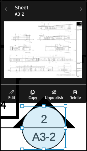

After you have published your sheets, they will be available to view in the sheets list. Autodesk Build will also begin to scan the content of your newly published sheets and match sheet number callouts to other sheets contained in the project.
If the sheet number callouts match the sheet number of any sheet in the project, those references will be converted into links. When you click the converted callout link, you can jump to the referenced sheet instead of having to search for it manually.
Note: The link processing time varies, as it can take a few minutes to a few hours depending on how many sheets the project contains and how many links need to be generated.
You can edit, copy, unpublish, or delete the automatic callout as a normal markup. See Markups Links and References for more information. You can also manually link any callouts which haven't been turned into links after publishing.
Edited callouts will also copy over when a new sheet version is published.
Deleted callouts will not copy over to a new sheet version.
