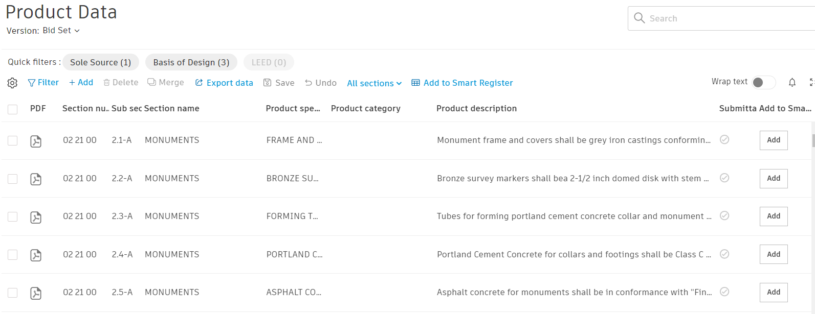

Once you've uploaded a specification to AutoSpecs, the Product Data tool allows you to see all of your product data in one place. You can also add more data and edit or merge items.
View Product Data and Configure Views
The Product Data tool provides a highly customizable way to view, manage, filter, and sort product data that has been imported into AutoSpecs.
From this view, you can configure columns, add or remove columns, and filter and sort product data.
Configure Columns
The Product Data tool gives you full control over how you view your list of data.
To add or remove columns in the table:
Click the gear icon.
Select columns that you want to view and deselect those you don't want to appear.
By default, the Product Data tool truncates lines of text so that more data can be displayed. You can choose to display all text in a column using the text wrap feature.
Enable text wrap using the Wrap text button on the right side of your screen.
