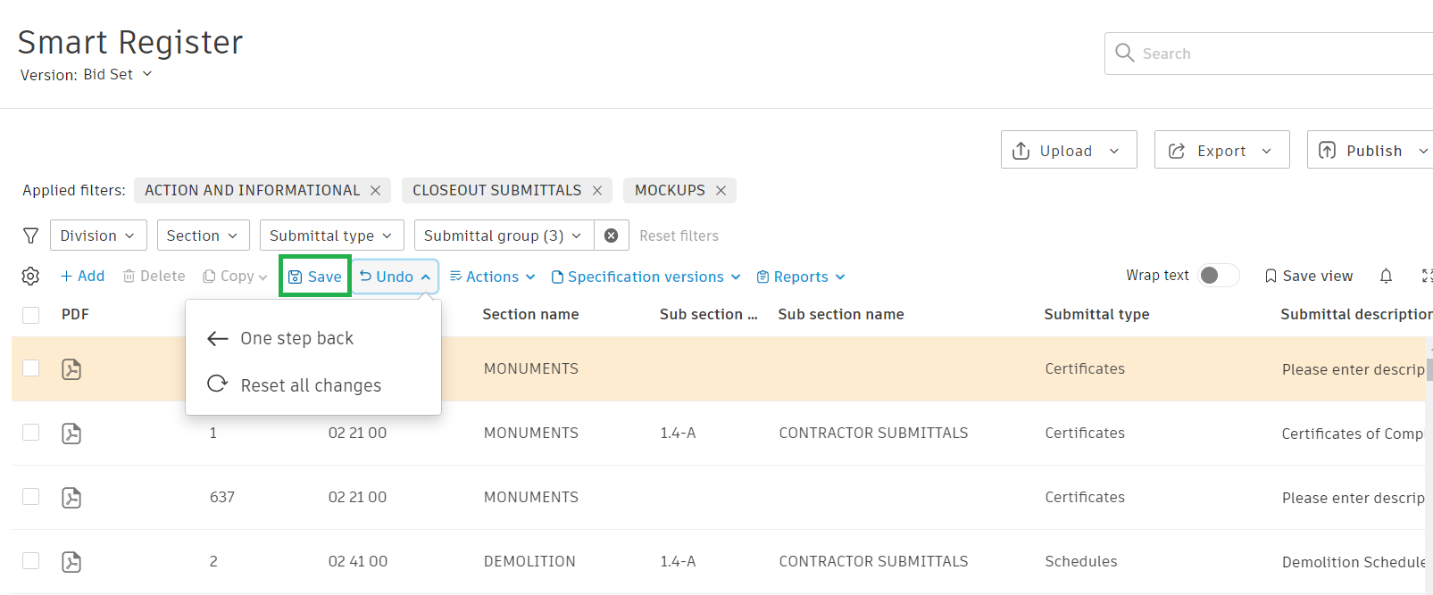

Save and Undo Changes
Changes to the Smart Register tool are not saved automatically when an action is taken. Save your changes periodically to avoid losing work.
Use the Save button on the top of the Smart Register table to save all changes.
Use the Undo button to reverse saved changes. You can undo either a single action or all actions since you began editing the imported submittal log.
