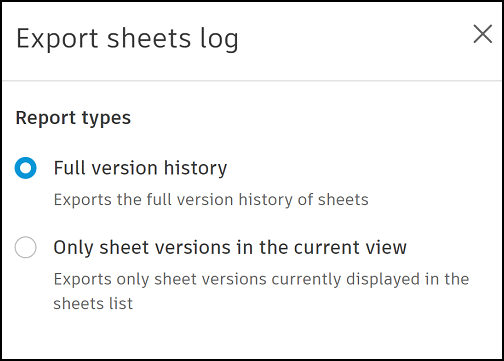

No Search and Filters Applied
If you haven't applied any search and filters, you can select from the following options:
Report types
  • Full version history: Includes all current and previous versions of sheets.
  • Only sheet versions in the current view: Includes only the sheet versions displayed in the sheets list after any search or filters are applied.

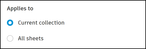

If collections is enabled in the project, you can also choose to refine the sheets log to the Current collection or All sheets in the project.
  1. Select your options as desired.
  2. Click Export.

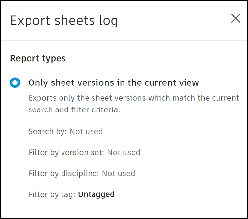

If you have applied search and filters, your export options have already been determined in the search and filters panel.
  • Only sheets and versions in the current view: A log of the sheet versions displayed in the sheets list after any search or filters are applied.
The search keyword and filters you've applied are also detailed in the Export sheets log panel.
  • Search by
  • Filter by version set
  • Filter by discipline
  • Filter by tag
  1. Click Export
You will receive an email with a link to download an XLSX file of the relevant sheets log.
