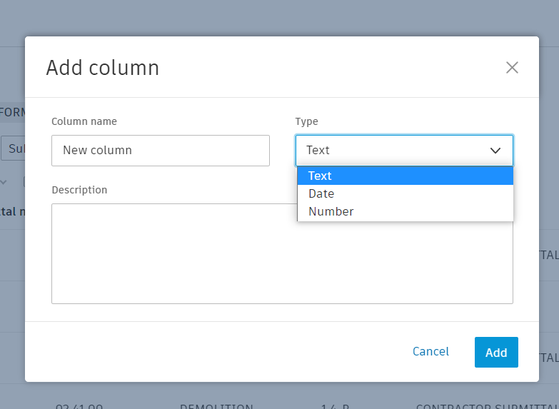

To add a custom column:
- Click + Add.
- Enter a Label for the column.
- Enter a Type (text, date, or number).
- Add a description.
- Click Add.
