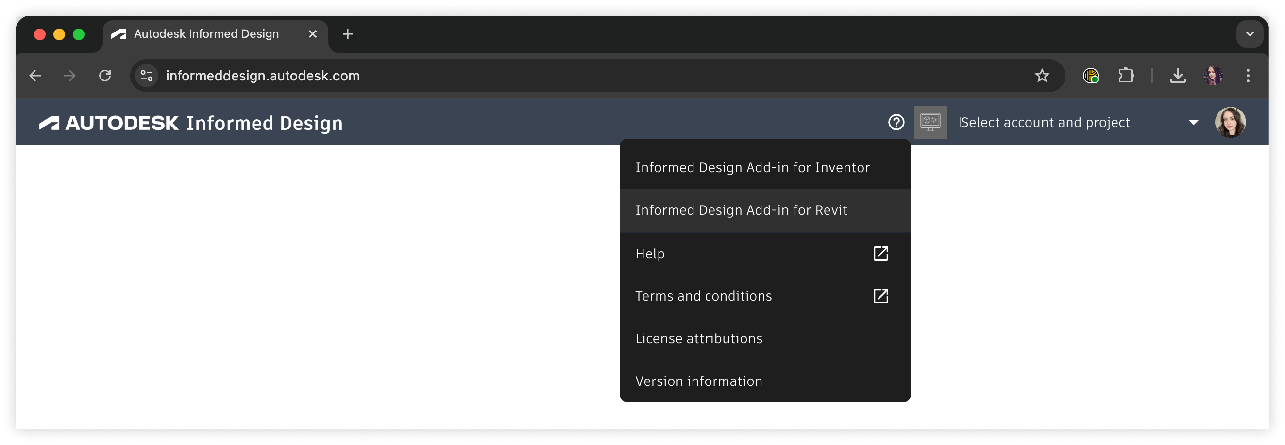

- Go to informeddesign.autodesk.com and log in using your Autodesk account credentials.
- Click on
in the title bar and choose Informed Design Add-in from the drop-down menu or go directly to the Informed Design Add-in for Inventor link
- Click on the Inventor tab.
- Select Download Add-in for your Inventor version year.

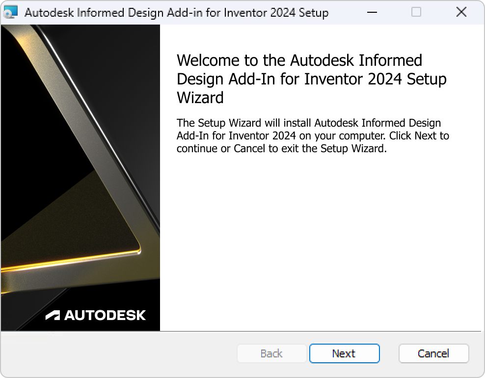

- Click on the downloaded file (e.g. Informed Design Add-In X.XX.X.X for Inventor XXXX.msi) to launch the Informed Design Add-In Setup Wizard.
Follow the installation Wizard instructions to complete the add-in installation process. Make sure Inventor is not currently running before installing this add-in.

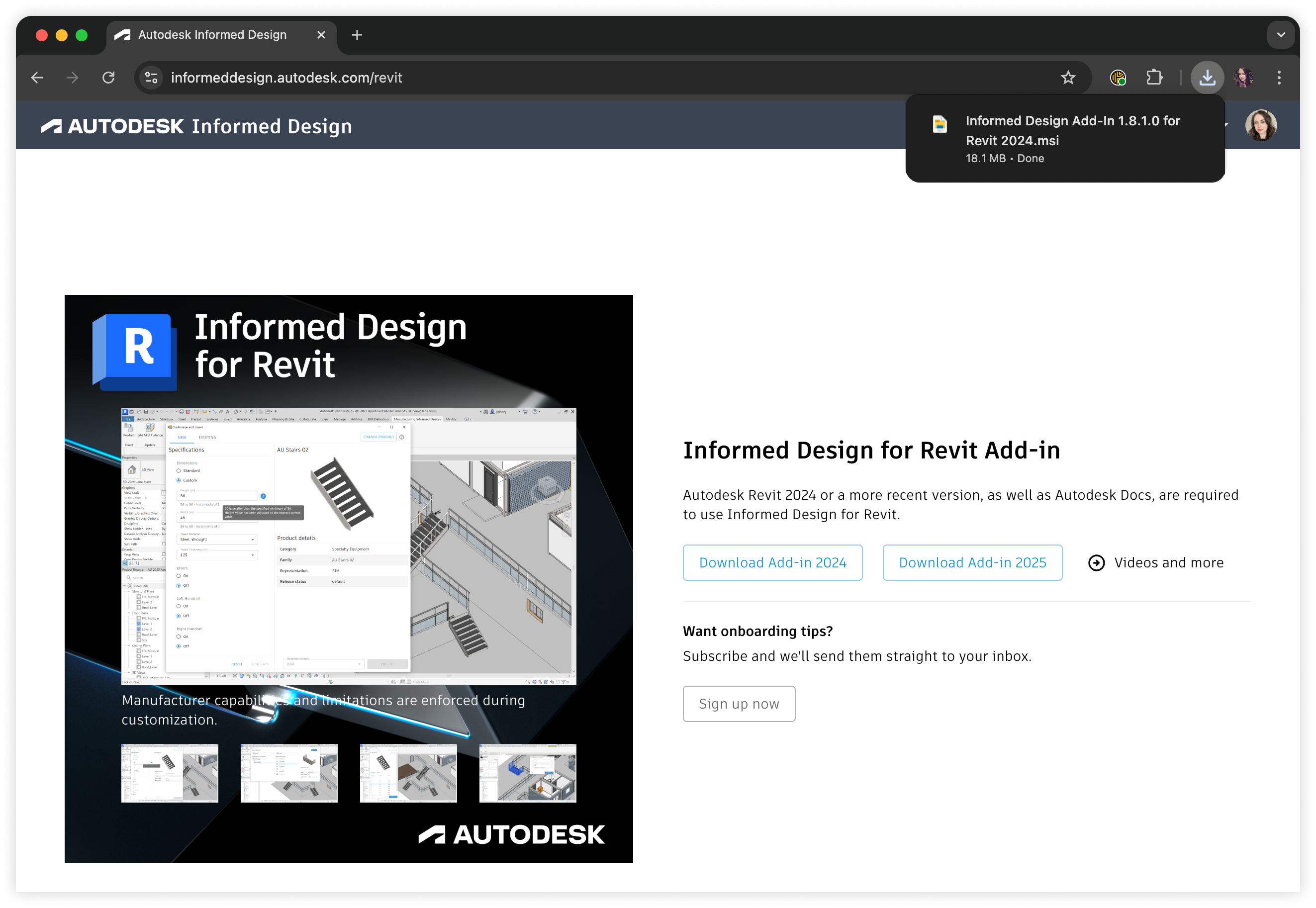

- Go to www.informeddesign.autodesk.com and login using your Autodesk account credentials.
- Click on
in the title bar and choose Informed Design Add-in from the drop-down menu or go directly to the Informed Design Add-in for Revit link.
- Click on the Revit tab.
- Select Download Add-in for your Revit version year.

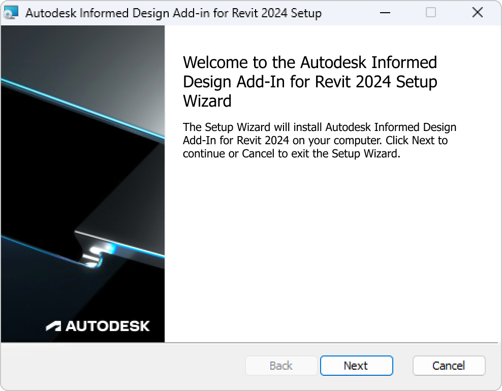

- Click on the downloaded file (e.g Informed Design Add-In X.X.X.X for Revit XXXX.msi) to launch the Informed Design Add-In Setup Wizard.
- Follow the installation Wizard instructions to complete the add-in installation process. Make sure Revit is not currently running before installing this add-in.
