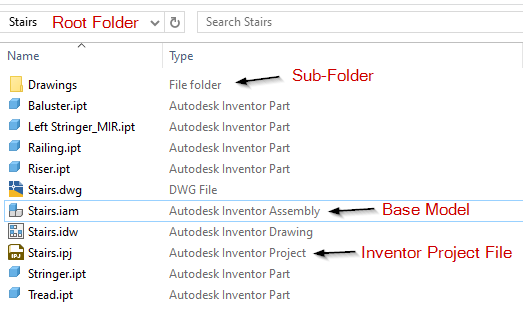

Inventor Project Structure
  • All files related to the Inventor Project to be published using Informed Design must exist under a single root folder with no external dependencies such as links out to common Library files, Content Center components, or Vault folders. Any sub-folder structure under the root folder in the Inventor Project is permitted.
  • Only include the files (i.e. parts, assemblies, drawings, etc) in the root folder that are essential for the Inventor model to work as a template for creating the various configurations it supports. Informed Design works by using Inventor running in the cloud where it can open your Inventor Model (the one you publish) and reconfigure it as you can on the desktop. Files not required to reconfigure the model on the desktop are also not required in the cloud.
    • NOTE: The root folder size of the assembly selected cannot be greater than 500MB.
  • Include a single dedicated Inventor Project File (.ipj) in the root folder
  • The Base Inventor Model (the Product to be published) can be an Inventor Part or Assembly file.

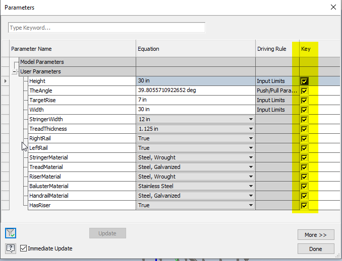

Input Parameters
  • In Inventor, create User Parameters for all Parameters to be adopted into the Informed Design Product Definition including those intended as configuration Input Parameters and those also required for any math and/or logic needed to calculate configuration related parameters.
  • User Parameters must be defined in the Base Model (i.e. root assembly or part) to be published, as these are the parameters that drive the main configuration Inputs.
  • Use an iLogic rule to push these parameters values down into the sub-assemblies and parts to reconfigure the model
  • As a best practice, corresponding Parameters in the sub-assemblies and parts should be given the same names as the Parameters in the Base Model for clarity and ease of use when defining the rules.
  • You should also consider using Parameter names that are as close as possible to the Input names you want to expose to the Revit User when they are using your Product and interacting with those Parameters as options for configurations. The final Input label text that appears on your Product Form can be set using Codeblocks.
  • Define initial Multi-Value lists for Input parameters in Inventor so that you can take advantage of the codeblocks that will be automatically created for these upon adoption into a Product Definition. Refinements to the values list for each parameter can be made with the resulting codeblocks.
  • Set the "Key" flag for all Input Parameters in the Inventor Parameters dialog. This will make it easy to identify and filter for these Parameters during the adoption step in the Product Definition.
