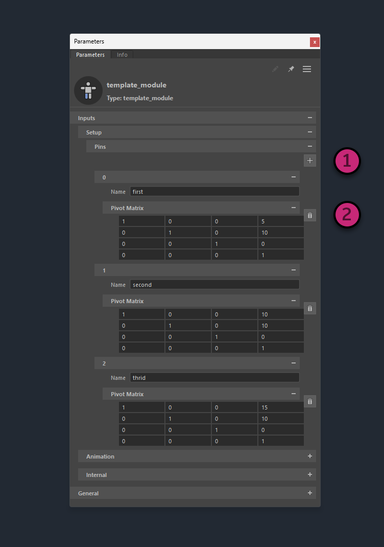

Arrays
You can add and edit items in an array directly in the Parameter Editor when there's no input connected.
  • Use the plus (1) button to add a new element.
  • Use the trash (2) button to remove an existing element.
arrays in the Parameter Editor
