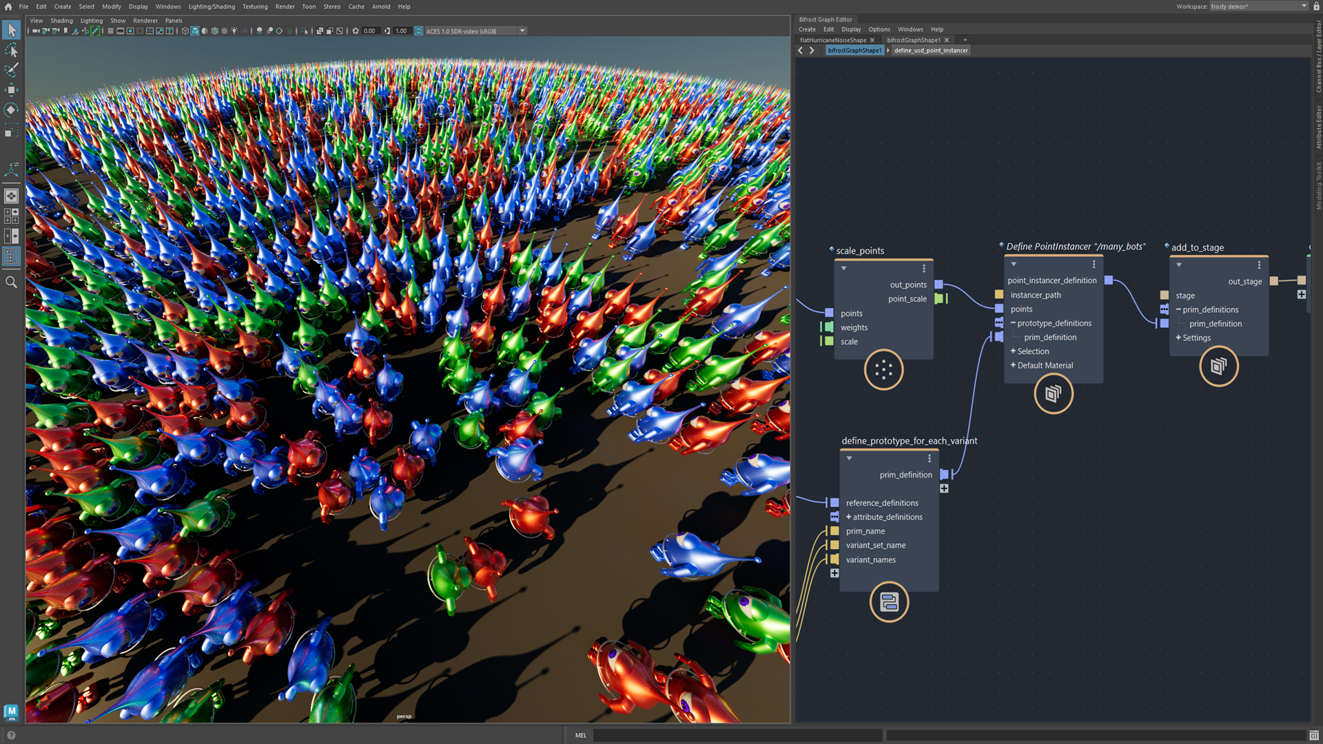

Bifrost-USD combines the ability of USD to assemble, organize, and edit assets non-destructively with the flexibility and proceduralism of the Bifrost graph. For example, you can use Bifrost to easily create USD Point Instancers that instance USD assets.
Bifrost-USD features both high-level compounds to easily and quickly populate a USD stage with layers and prims, as well as low-level nodes that match the capabilities of the USD API. It is integrated with USD for Maya, letting you see, select, and adjust elements directly in the viewport.

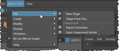

To enable the plug-in, add the path to the folder that contains the bifrostUSDExamples.mod file to your MAYA_MODULE_PATH environment variable (for example, in your Maya.env file), then restart Maya and load bifrostUSDExamples.py using the Plug-in Manager. A new menu Bifrost USD appears on Maya's main menu bar.
