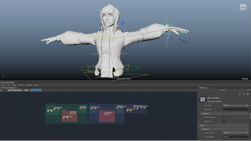

A module's pins are used to define the rest pose of controls and joints. The rest pose of a transform consists of world space matrix called pivot matrix. Pins are helper transforms that act as guides for their rest transformation. Default pins are stored on the module's inputs port. The relationship between pins and the entities they drive is defined in the module's user_setup sub-compound.
The animation state of transforms is driven by the operator matrix passed to a module's inputs port. The operators are automatically applied on their respective transforms by the module. To do more complex transform operation such as solving an IK, you can work in the user_animation sub-compound.
Within user_animation, you have access to the already-solved transforms, which can be used to compute new matrices that update control or joint transforms. The final transforms are passed to a module's outputs port, so that they can be used by other modules or by objects in the host scene.

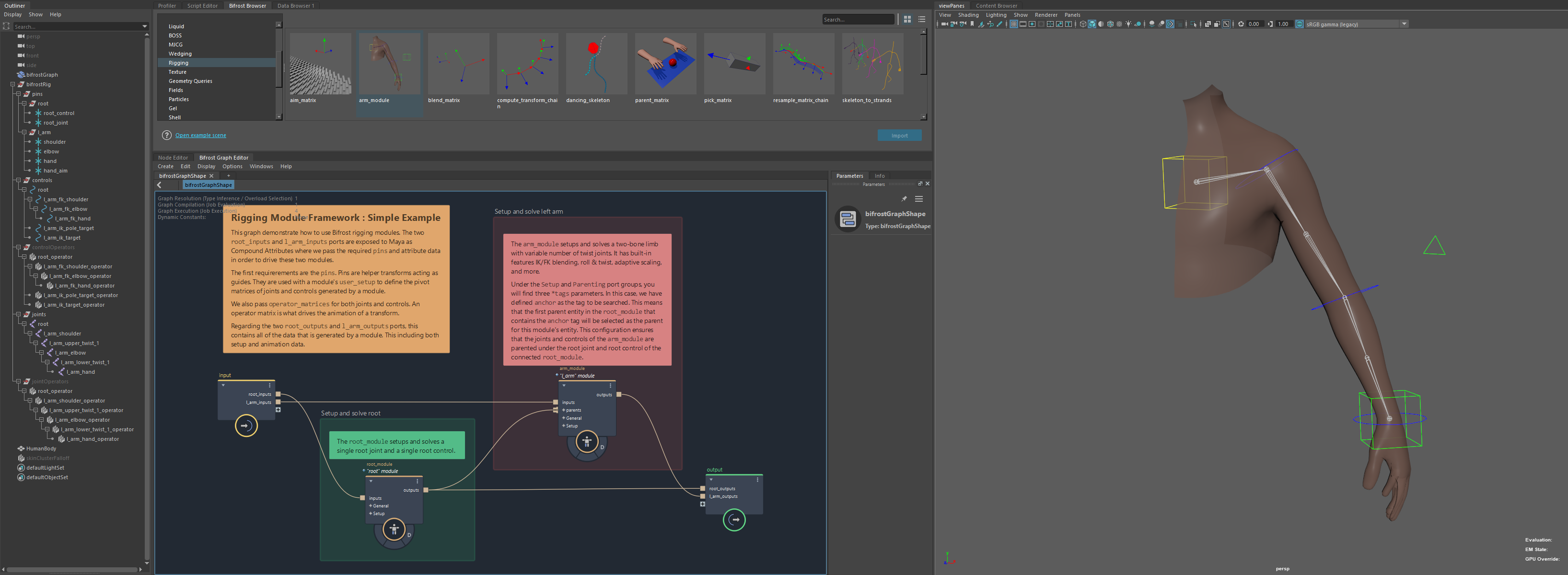

Examples
You can take advantage of the existing modules and examples provided with the framework. Whether you're building a full character rig or exploring how individual parts are constructed, these modules are designed to be both practical and educational.
The modules in the
Rigging::Modulesnamespace of the Tab menu and Node Library serve as building blocks that you can use and customize for your own rigs and modules.The sample graphs in the Rigging section of the Bifrost Browser serve as examples showing how to use and combine modules. You can explore and learn from them, or adapt them for your own scenes.
