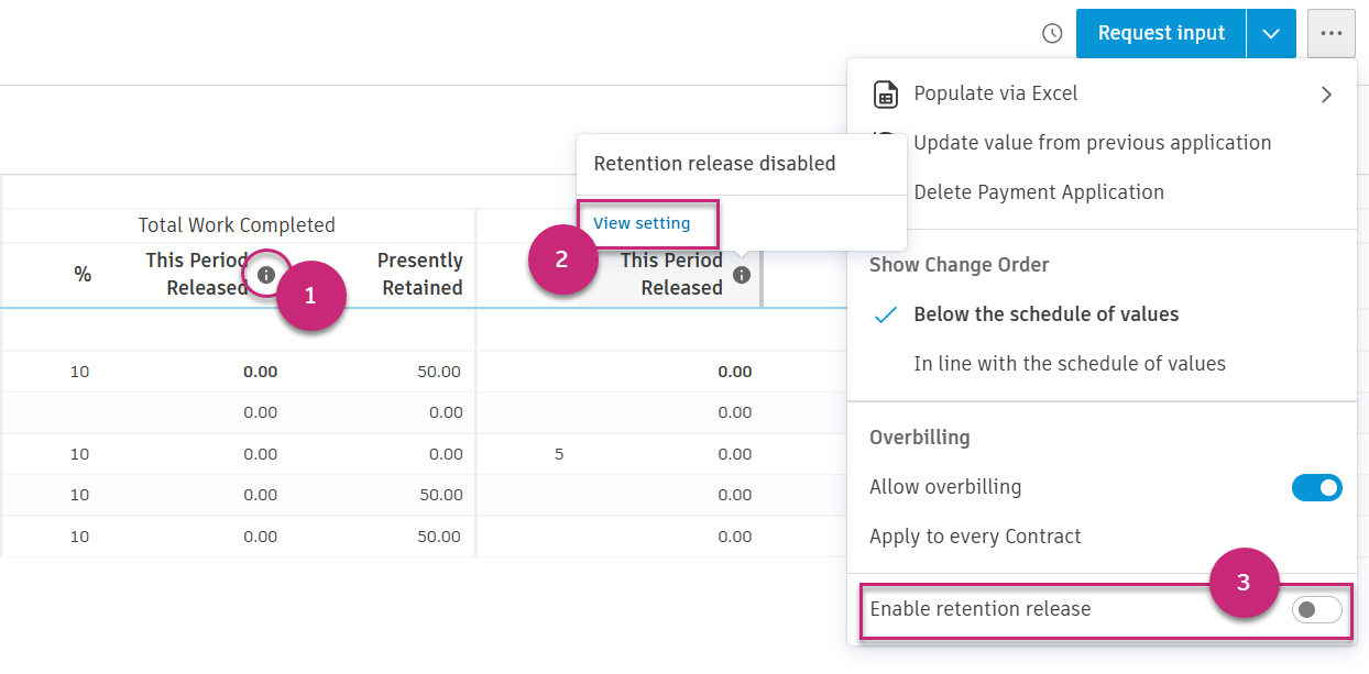

Retention Release
Retention release is the payout of retained funds to contractors or subcontractors after meeting milestones, such as project completion, and passing required inspections and approvals.
Members with Full Control permission and project administrators can toggle the Enable retention release option. Project administrators can also adjust retention settings in General Settings.
This option is disabled on default for new payment applications. If the option is disabled:
  • This Period Released columns in Retention Total Work Completed and Retention Materials Stored (Materials Billed) show 0 and are uneditable.
  • Changes to Total Work Completed Retention % affect only This Period Work Completed Retention.
  • A message in the column header displays: "Retention release disabled." A link to settings is provided. You can click it to enable retention release for this payment application:
    Enable retention release path
Steps to release retention for a payment application:
  1. Navigate to the Cost tab.
  2. Switch to the Cost Payment Application tab.
  3. Open the cost payment application details Open details view icon.
  4. Click the More menu icon in the top-right corner of the table.
  5. Toggle Enable retention release.
If the option is enabled, members with Full Control permission can:
  • Release retention or edit values in the retention columns. This Period Released columns in Retention Total Work Completed and Retention Materials Stored (Materials Billed) are editable.
  • Changes to Total Work Completed Retention % update This Period Released.
Note: You can also turn off this option on payments with previously enabled release retention. If the toggle is turned off with existing values in the Release column, the values are cleared, added back to Presently Retained, and the retention % recalculates.
