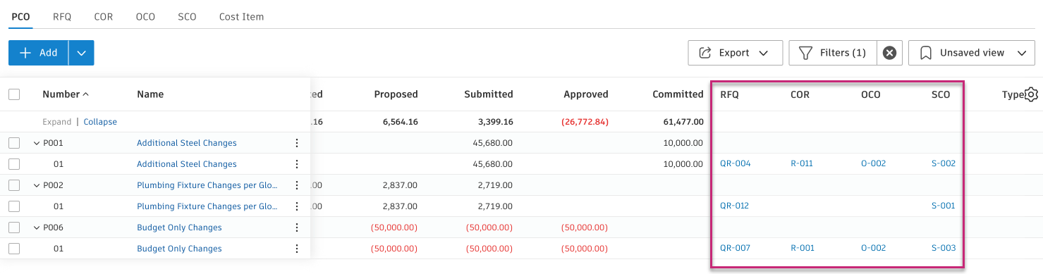

The change order tables provide detailed information on cost items, including the associated change order number. By clicking each number, you will be redirected to the specific tab where the corresponding change order is located. A flyout panel will open to provide further details.
Note: Members with collaborative access don't see columns with associated change orders.

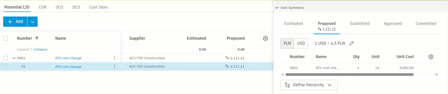

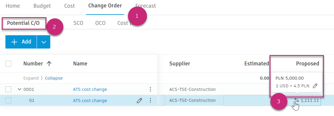

The Estimated, Submitted, and Approved values will always be entered in base currency. Yet, you’ll see changes in the Proposed and Committed values. The base currency will be displayed with the icon next to it. Hover over it to see or edit the exchange rate:
You can also manage this information within the Cost Item’s flyout panel. First, select the item to open the flyout panel, then scroll to the Cost Summary section. Then, select the Proposed or Committed columns. Toggle between the two currencies and edit the exchange rate whenever needed.
You can copy values from the Estimated, Submitted, and Approved columns. Those values will be converted from the base to the foreign currency.
