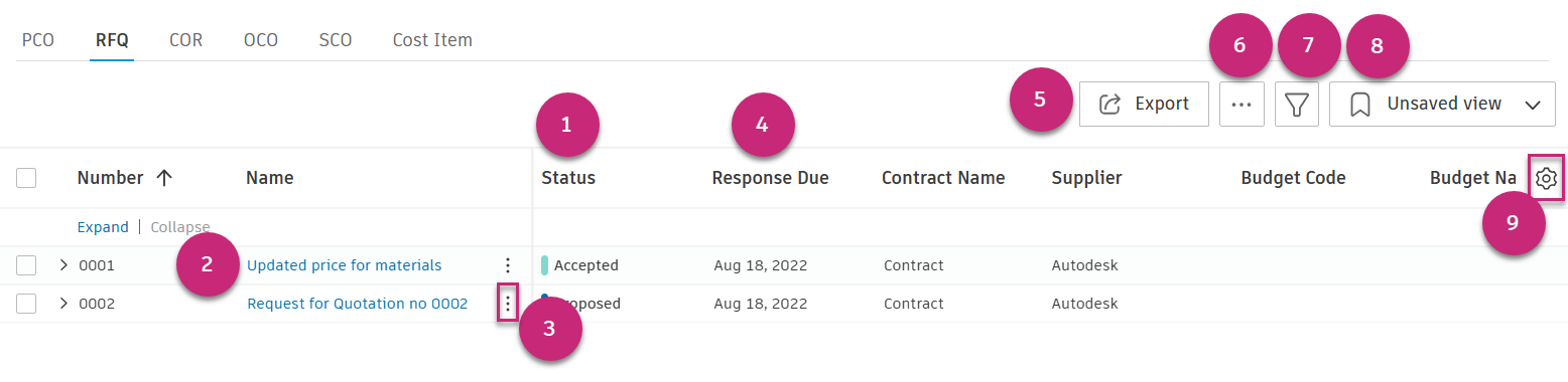

RFQ tab overview showing the main interface with numbered callouts for different features and sections
  1. The item's status automatically updates to Draft after an RFQ is generated from a PCO.
  2. Select the item's name to open the flyout panel. Editing the RFQ can be done within the flyout panel. In the flyout panel, selectable workflow-based actions will appear to guide you through the change order management process.
    RFQ flyout panel showing workflow-based action buttons like Request Quotation, Set as Proposed, and Reject
    For example:
    • When the RFQ status is Open, the Request Quotation button is visible. Note that a supplier needs to be listed in the Supplier Details section.
    • Once the RFQ is sent, the next options appear: Set as Proposed or Reject, and so on.
    • When Accepted, select SCO to generate a Supplier Change Order.
  3. Click the More menu Vertical more menu icon to generate change orders, set the status of the RFQ, or delete the item.
  4. The Response Due column will be populated when a date is added in the dates section of the flyout panel.
  5. Click Export to create an RFQ report.
  6. Click this icon to show or hide change orders' hierarchy. To learn more about using the hierarchy view to navigate between related change orders, see the Navigating Change Orders with Hierarchy View section.
  7. Click the Filter icon to filter and group the table.
  8. See the available predefined views of the table or save the current view of the table.
  9. Select the Settings gear icon icon to edit the position and visibility of columns within the table.
    Tip: By activating an Attachments column, you can instantly view the quantity of attachments for each RFQ, without the need to click each one individually.

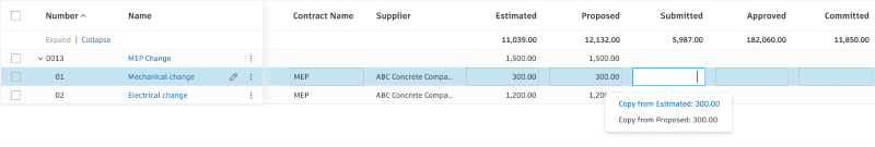

  7. Enter the necessary values into the Estimated and Proposed columns. You can copy cost item amounts from another column.
    Interface showing cost item amounts being copied from one column to another at the change order level

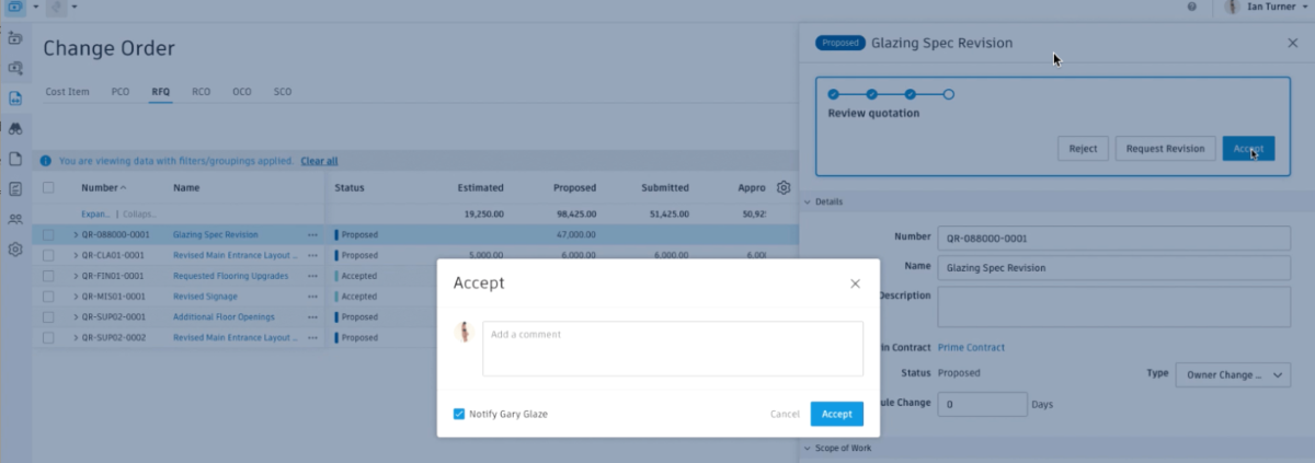

Once the RFQ is sent, the next options appear: Set as Proposed, or Rejected, and so on. See the Change Order Statuses article to learn more about the RFQ status workflow.
A supplier will be notified of the quotation request by email when they have a collaborative permission for RFQs. The status is set as Pricing. See the Change Order Statuses article to learn more about the RFQ workflow statuses.
Note: You can also generate an RFQ as a PCO in a collaborative workflow. See the Collaborative Potential Change Order article. You can also generate an RFQ from a cost item.
When Accepted, project administrators can request extra revision or generate SCO to finish the change order workflow.

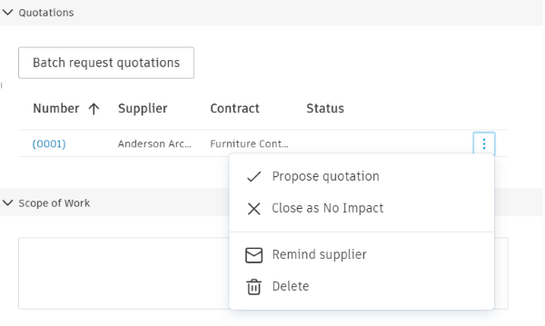

Batch Request Quotations

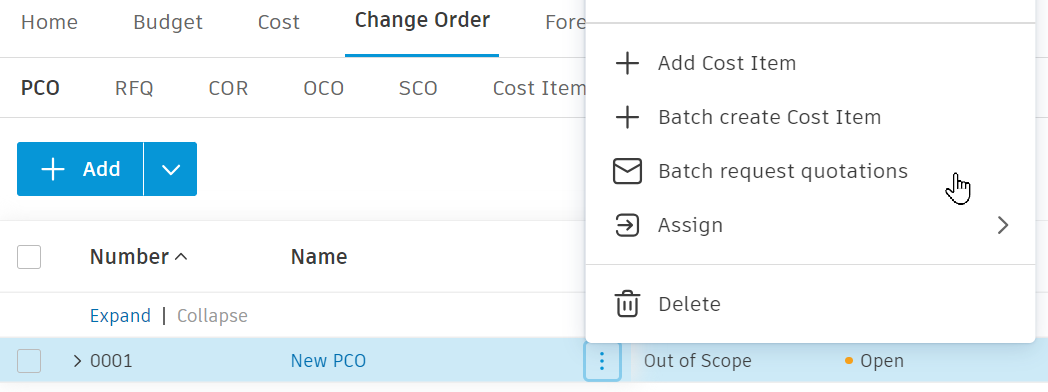

In addition to generating an individual RFQ, you can batch-request quotations from a PCO. A batch-request quotation is useful when a change occurs, and it is unclear who might be affected by this change. To reduce the risk of missing anyone, send a batch request to all suppliers to let them indicate whether they are affected or not and keep a record of their response.
To create a batch request:
  1. Click the Change Order tab.
  2. Click the PCO tab.
  3. Click the More menu Vertical more menu icon of a PCO and choose Batch Request Quotations.
    Batch Request Quotations option in the More menu of a PCO
  4. You can add a filter for contract type in the newly opened window.
  5. Select one or more suppliers.
  6. Write a message to be included with the request.
  7. Select a Due date.
  8. If necessary, choose Attachments to include.
  9. Click Send.
    Batch Request Quotations window showing supplier selection, message field, due date, and attachments options
Placeholder cost items are generated for each supplier and are shown in parentheses. Suppliers can respond by saying no impact or can propose a quotation.
Table showing placeholder cost items in parentheses generated for each supplier in batch request
The placeholder cost items will be converted to regular cost items when a quotation is proposed.

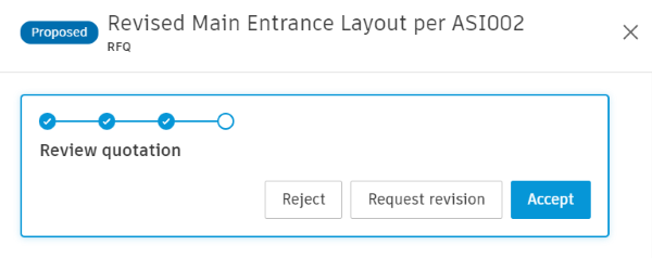

Once submitted, the system will notify a general contractor by email. They can review all RFQ quotations in the PCO view by selecting each cost item and looking at the attachment. Then, they can either accept it or request a revision.

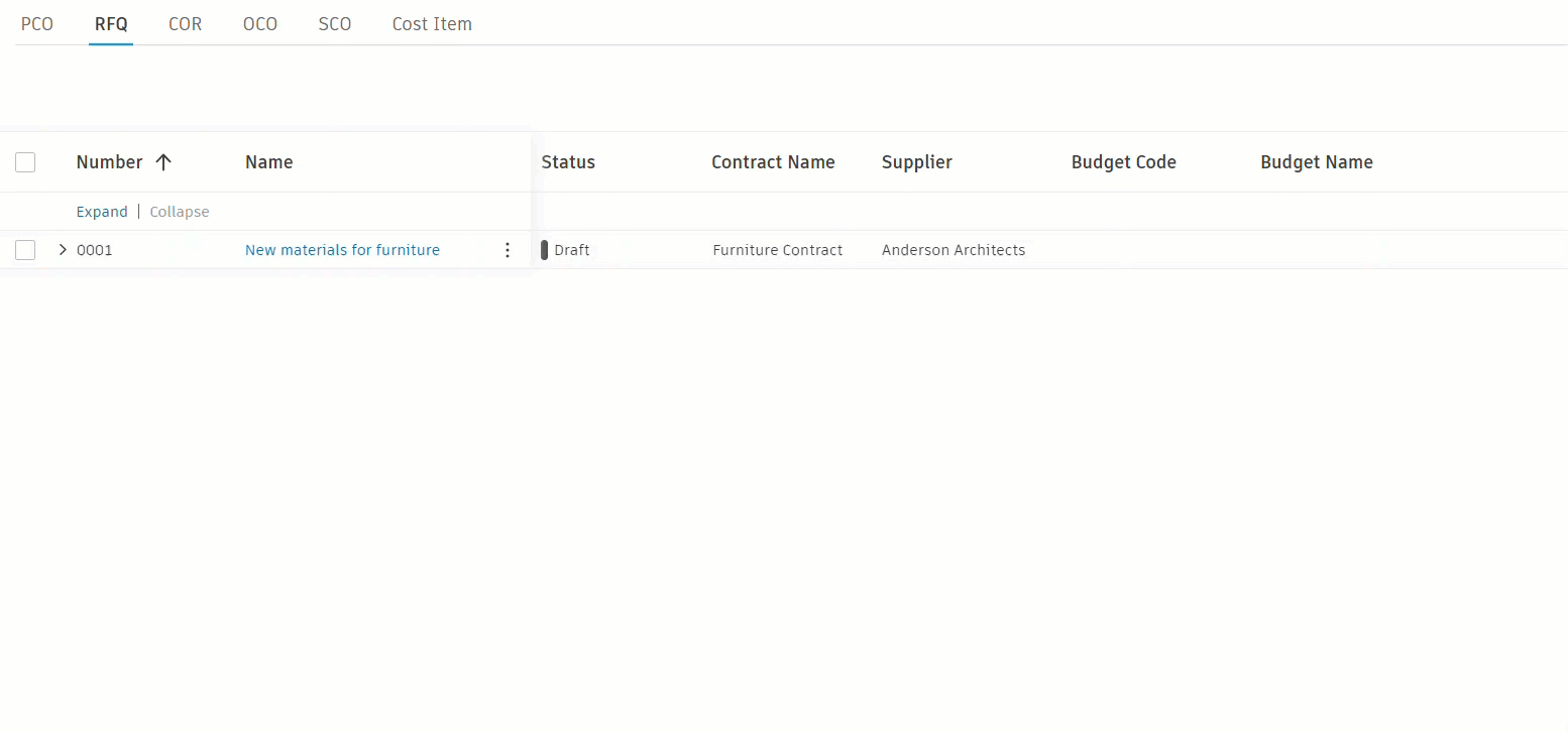

Detach a Cost Item from an RFQ
To detach a cost item from an RFQ, expand the row and select the More menu Vertical more menu icon or check the box. The detach button will appear. It will still be part of the PCO.
Animated demonstration of detaching a cost item from an RFQ by expanding the row and selecting the detach option
