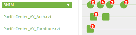

Data set courtesy of BNIM.
In addition to the aggregated project model, teams can view individual models uploaded to Document Management.
When you explore a package from the timeline, you can view an aggregation of the unconsumed package and the consumed or work-in-progress data from your team. In this case, the aggregated model can be used to show changes between the different packages and the packages consumed by your team.
