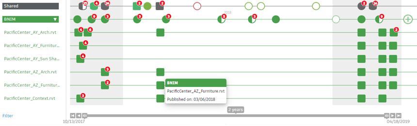

The timeline at the top of the screen tracks the packages that collaborating teams have shared and consumed throughout the lifecycle of a project. Essentially, the timeline is the official record of exchange of deliverables throughout the project. It not only visualizes the package exchange events, but it allows design leads to view, create, modify, and consume packages from one streamlined interface.
Additionally, for teams that collaborate internally or those that collaborate externally using Cloud Workshared Revit models, the timeline displays published models.
Timeline Handle
The timeline handle dynamically adjusts to give you additional commands. This allows you to quickly expand, collapse, or close the timeline in one click.
Click the handle at the top of the screen to open the timeline
.Your team’s packages are displayed on the bottom line. The Shared line is a collection of all the other teams’ packages.
Click the down arrow on the handle to expand the Shared line to view all teams in the project
Click the up arrow on the handle to collapse the timeline, or click the Close icon on the handle to hide the timeline from view

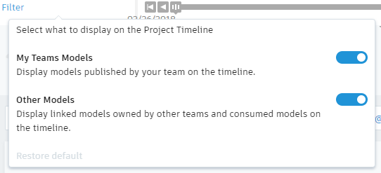

Filter Models on the Timeline
By default, the timeline shows a combination of packages and models from your team as well as those shared by other teams. You can filter the timeline to hide linked models from your team or other teams. To do so:
- Click the handle at the top of the screen to open the timeline
. - On the left side of the screen and below the teams on the timeline, click Filter.
- Toggle off My Team's Models to hide linked models from your team. Packages from your team are always displayed.
- Toggle off Other Models to hide linked models from other teams. Packages shared by other teams are always displayed.
