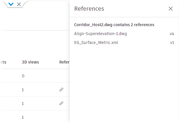

Work with References

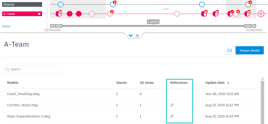

When DWG files have been uploaded to team folders in Document Management, they are displayed in the corresponding Team Space in Design Collaboration.
Files that have XREFs have an icon displayed in the References column:
Click the icon to open the References panel, which displays the names and versions of the referenced files:

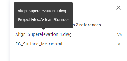

Hover your cursor over a referenced file to see its folder location:
