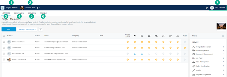

Navigate the Project Admin Module
Familiarize yourself with the basic user interface (UI) components to more efficiently navigate the Project Admin module.
- Project Selector: Toggle between projects you have access to.
- Module Selector: Toggle the BIM 360 module you want to work with. You can only select currently activated project services.
- Members tab: Invite account members to a project and determine their access to activated modules.
- Companies tab: View a list of project members' company affiliations.
- Services tab: Activate and manage project services and add project administrators.
- Profile tab: Edit the project name and logo.
- Help Menu and Autodesk Profile: Find additional resources, including Forums, Support, and the Learning Panel.
