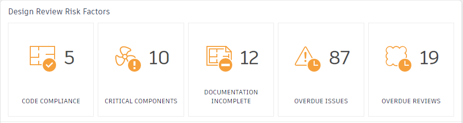

Design Review Risk Factors
  1. Within the Design tab on the Insight module or in Project Home, add the Design Review Risk Factors card from the Card Library to see risks with:
    • Code compliance
    • Critical components
    • Incomplete documentation
    • Overdue issues
    • Overdue reviews

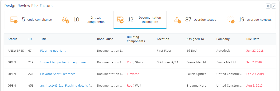

  2. Click any of the filters for the design review risk factors to see an expanded view.

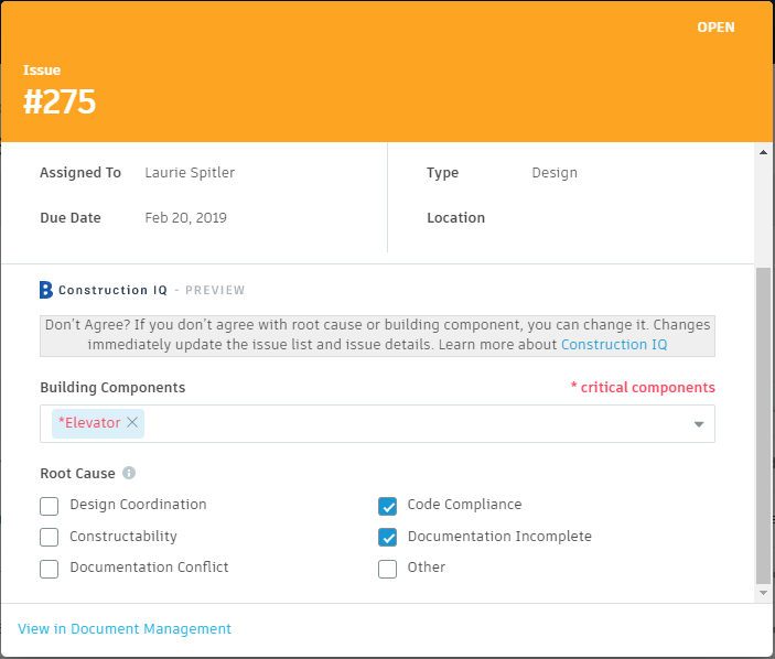

With each risk factor, the Root Cause and Building Components are predicted by Construction IQ. Project leads can override these two attributes. To do so:
  1. Click the Title of an issue from the list.
  2. Remove any Building Components listed as necessary.
  3. Deselect the Root Cause as necessary.
For example, in the image below, you would remove Elevator and deselect Code Compliance and Documentation Incomplete.
