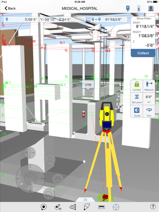

The Autodesk BIM 360™ Layout app provides vertical construction contractors the ability to connect the coordinated model to the field layout process. The app helps increase job site productivity while improving the accuracy of staked or installed building components.
Using the BIM 360 Layout app with BIM 360 helps to streamline processes. Create field points in your project model, and then lay out those points on the job site with a total station or GPS.
The app synchronizes with your BIM 360 account to allow you to work with project models with point location coordinate detail. Once paired with a total station or GPS, BIM 360 Layout on your tablet or phone guides you to the exact location of those points on the job site for field staking or location verification activities.

  • Utilize an intuitive 3D model-based app interface for navigating and locating point coordinates on the job site.

  • Control the total station remotely utilizing guide and point-turn functionality.
  • Intuitive, step-by-step configuration using known point and resection workflows for total station set-up.
  • Real-time model navigation for conducting layout, QA/QC, and creating as-builts on the job site.
