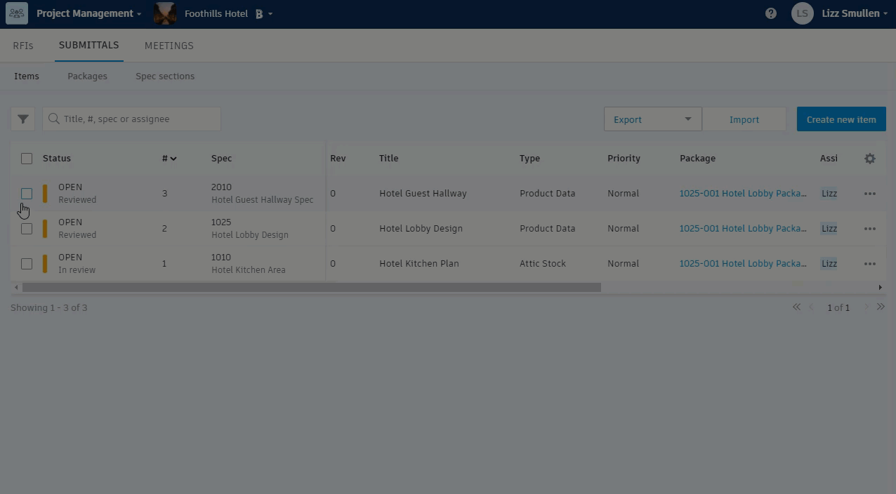

Bulk Action Workflow
  1. Click the Module Selector .
  2. Select the Submittals tab.
  3. Select the Items tab.
  4. Select items using the checkbox on the left side of the item in the list.
    Tip: The actions available may differ depending on the items selected. Hover over an action to see the requirements for that action.
  5. Select an action.
  6. If necessary, make desired changes. Set as Void and Remove from package don't require more entries.
