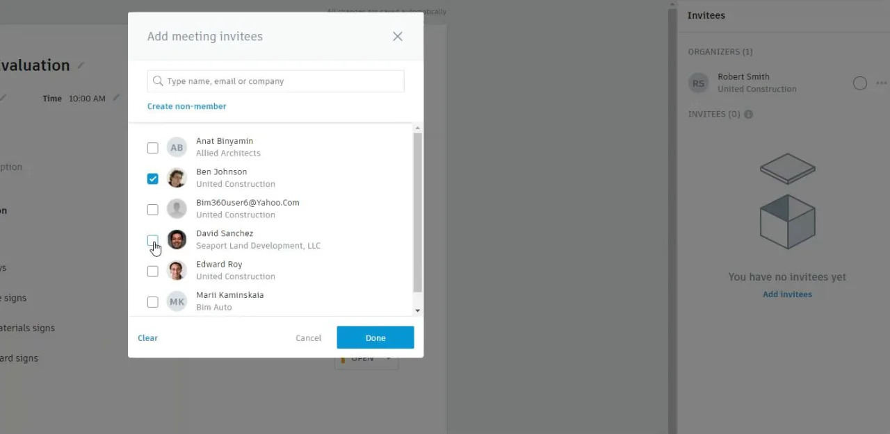

Add Invitees
- Click Add invitees.
- Select members from the list. You can select more than one.
- Click Done.
If they are not members of BIM 360 you can add external members. This can be done while adding other invitees.
- Click add invitees.
- Select Create non-member.
- Enter their first name, last name, and company into the mandatory fields. Email is not mandatory.
- Click Create.

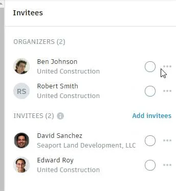

Manage Organizers
To be an organizer of a meeting, you must be a BIM 360 member. Meetings must have at least one organizer.
Use the More menu next to an invitee or organizer to change their permission level.
