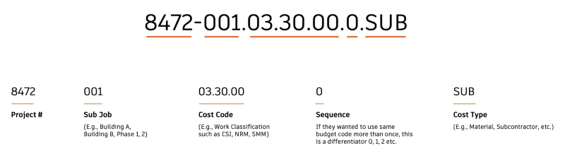

  12. Hover your cursor over the Budget code preview to see how the complete code will look after it's added or imported to the budget, even when imported into the system from your accounting system.
Here is an example of a real budget code:

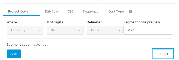

  1. Click Import in the Segment Code Master List section.
  2. Click Download Template.

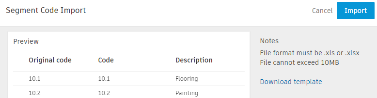

  3. Add and save your data in the Excel file to match the required format. See the summary of the format requirements:
    • Format: .xlsx or .xls
    • Size: ≤ 10 MB
    • Sheets: Only the first sheet in the spreadsheet is imported. All other sheets are ignored.
    • Columns: Code must be the first column header, followed by Description.
      • You may insert as many columns in between as required to achieve the desired level of hierarchy.
      • Hierarchy levels are unlimited. Child levels don’t require a column header; insert a column for each level of the hierarchy.
    • Every line item can only have one code. When importing, make sure to set “# of digits” correctly, or an error message will display.
    • Rows: Each description must be unique for a single segment code.
  4. Choose your saved file or drag it into the Segment Code Import window.
  5. Click Import.
  6. Click Done.

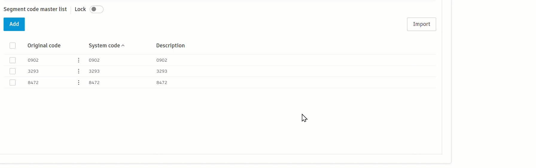

You can delete a segment value by selecting the checkbox next to the line item. Under the Segment Code Master List section, the Add button will turn into Delete. Click Delete. To delete all items, select the checkbox in the header row.

Lock a Master List
After defining budget code segment settings, you may lock the master list to have more control over it during the project. To do so, check the Lock Master List button:
Once this option is checked:
  • The master list can't be edited,
  • Only segment codes in the master list can be used in budget codes,
  • You cannot add new, remove, rename, or edit segments.
