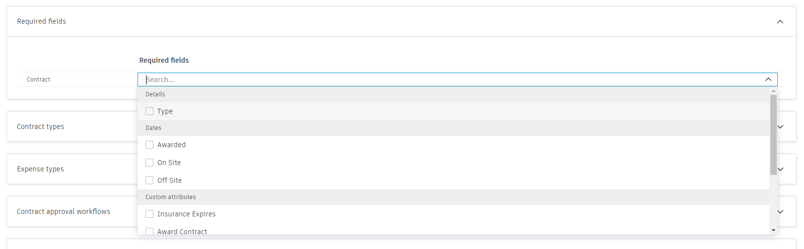

Required Fields for Contract
Project administrators can define a batch of fields as required when filling in data for a contract.
To do so:
- Click Module Selector
. - Go to Services, then click Cost Management.
- Switch to the Cost tab.
- Scroll down to Required Fields and click it.
- Choose which fields should be marked as required. Custom attributes are also listed and can be chosen.
After setting it up, when creating a contract, those fields are marked as obligatory and must be completed to proceed with the contract workflow. By clicking View, you'll be redirected to the missing data.

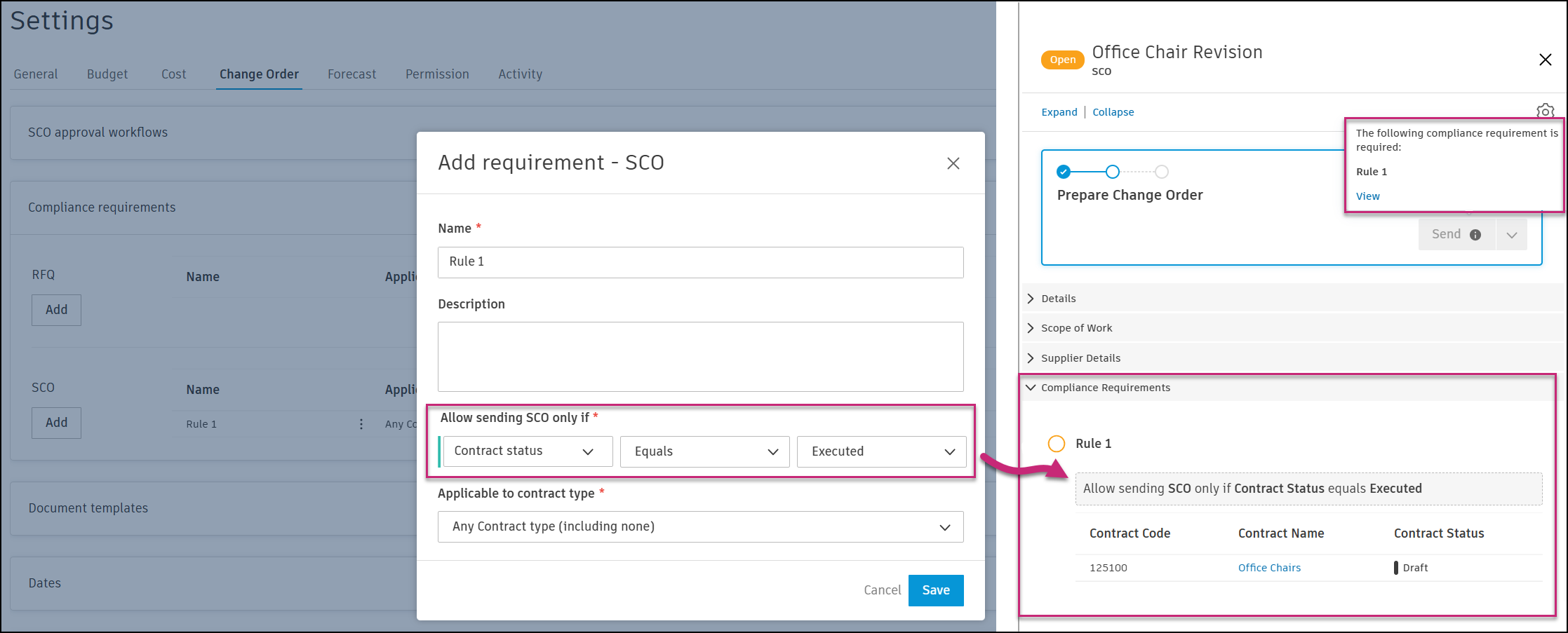

Compliance Requirements
Compliance requirements ensure that specific documents or conditions are met before contracts and cost payment applications can be submitted or processed. These requirements help maintain project standards, regulatory compliance, and ensure all necessary documentation is in place before proceeding with financial transactions.
To define compliance requirements for contracts and cost payment applications:
- Click the Compliance Requirements drop-down list.
- You can add compliance requirements by clicking Add next to Contract or Cost Payment Application. After clicking Add, the respective requirement window opens.
- Add the name and description of the requirement. These will be seen in the Compliance Requirements section in the contract details panel.
- Then, follow the steps below depending on whether you're setting up compliance for contracts or cost payment applications:
For Contracts:
Choose document-based or condition-based requirements:
For document-based: In Requirements to submit contract, Requires a document is a default option. You can choose an extra option Requires a document expiration date. See the Set Expiration Dates section in the Compliance Requirements article for more information.
For condition-based: Set a condition on which compliance will be based. For example, you can create a condition where you can't send contract unless the Original Commitment is less than a Revised Budget.
Note: If the requirement is non-compliant, you can choose to Block Contract Action or Allow Contract Action.
You can choose if the requirement applies to one, several, none, or all contract types.
Click Save.
For Cost Payment Applications:
Choose a document-based requirement. You can select an extra option Requires a document expiration date. See the Set Expiration Dates section in the Compliance Requirements article for more information.
Specify aplicability for this requirement:
Contract type: You can choose if the requirement applies to one, several, none, or all contract types.
Retention release status: Choose between Any, Released, and Not Released. Learn more about retention release.
Payment application status: Choose the applicable stage: Initial, Progress, or Final. Learn more about payment applications' stages.
You can create different sets of compliance for payment applications depending on the options you choose. A helpful note will appear, explaining how your choices affect the application. For example:
Click Save.
After adding a compliance requirement in Services, whenever compliance is not met during the workflow, you'll see a notification: The following compliance requirement is required followed by a list of unmet requirements. Here is the example:
See the Compliance Requirements article to learn how to work with these types of documents.

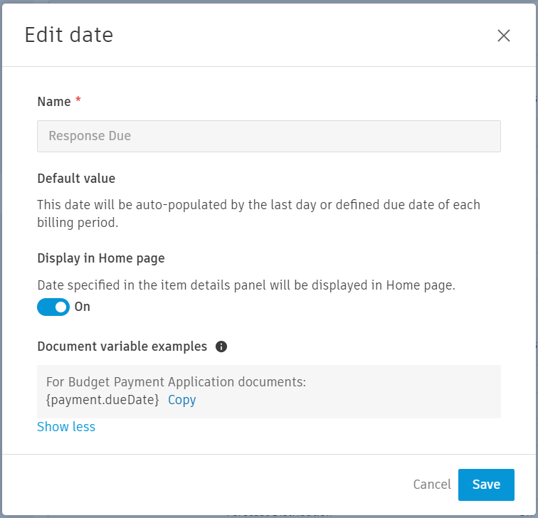

Dates for Contract, Cost Payment Application, Expense
You can define a default value for dates and choose to have them displayed on the home page. This will help you manage the schedule in Cost Management. To do so, open the More menu
and click Edit.
can't be displayed on the home page and can't be edited.If applicable, you can choose the default value for the date. Use the relative date option for cases where an activity is relative to the date of another activity (for example, creating a procurement schedule). The relative date option is only available for editable system-generated dates and custom dates.
Available document variable examples are shown by clicking Show More. You can use those to prepare a document template.
