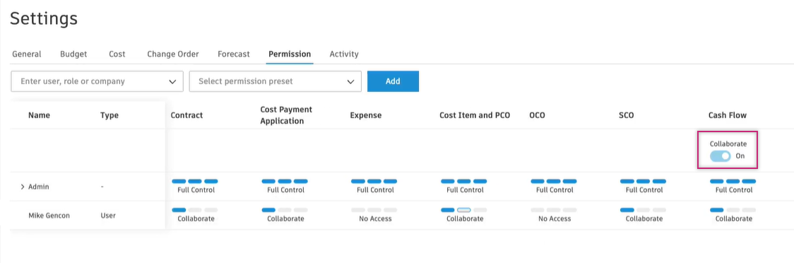

  1. Select the Settings tool from the left navigation.
  2. Switch to the Permission tab.
  3. Turn on the toggle button in the Cash Flow column. This enables the collaborative process in the Forecast tool.
    Cash Flow collaboration toggle button in Settings

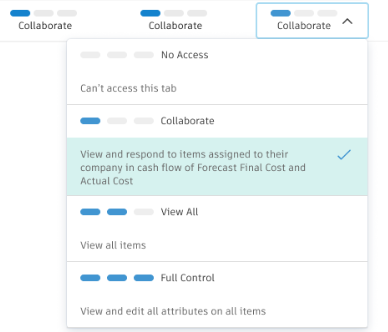

  4. Choose the Collaborate permission for the supplier role. This allows collaborators to view and respond to items assigned to their company in the cash flow of forecast final cost and actual cost.
    Collaborate permissions for supplier role

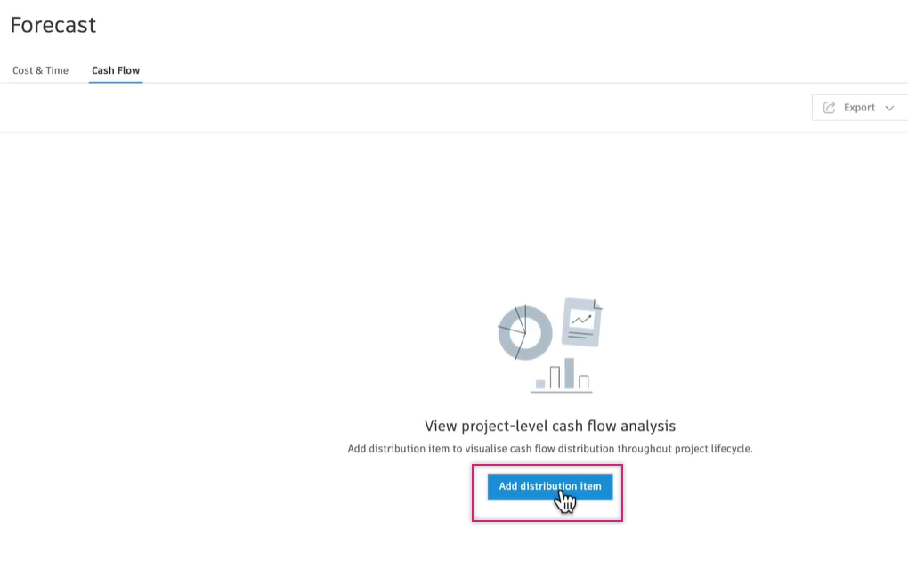

  1. Go to the Forecast tool from the left navigation and open the Cash Flow tab.
  2. Click Add distribution item.
    Add distribution item button

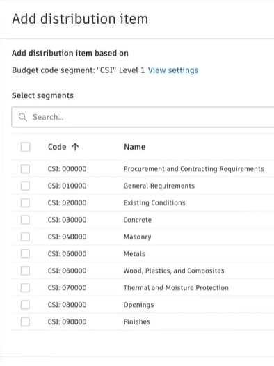

  3. Select budget segments from which you want to add items. Click Add.
    Budget segments selection dialog

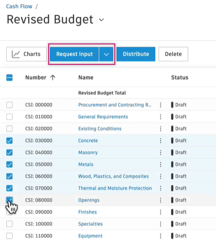

  4. Select all the distribution items that you want to send to the supplier and click Request input.
    Request input button for distribution items

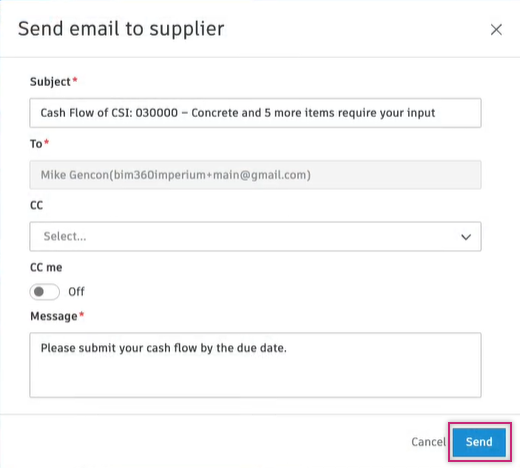

  5. A pop-up window appears with the supplier's email. You can write your message and click Send.
    Email to supplier popup window
Now, the supplier receives the email notification.

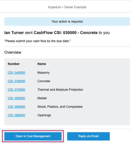

A supplier receives an email requesting their input. To respond, the supplier can do the following:
  1. Click the Open in Cost Management button in their email or go directly to Cost Management, choose the Forecast tool and then the Cash Flow tab.
    Open in Cost Management button in email

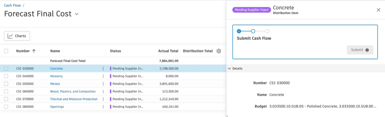

  2. Here, only their distribution items for forecast final and actual cost are visible.
    Visible distribution items for supplier

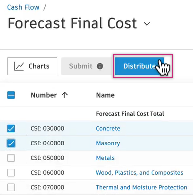

  3. Select the items that need input and click Distribute.
    Distribute button for selected items

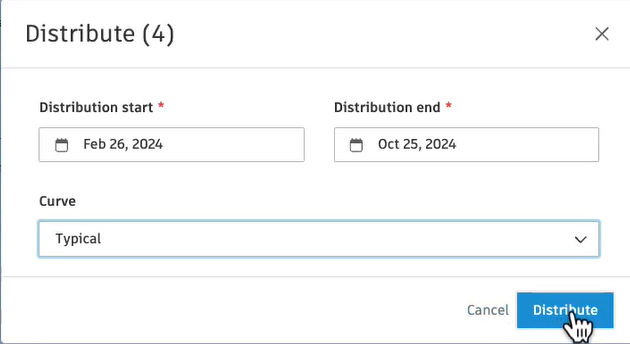

  4. Select distribution start and end dates, and set the Curve from the drop-down list. Confirm with the Distribute button.
    Distribution date range and curve settings

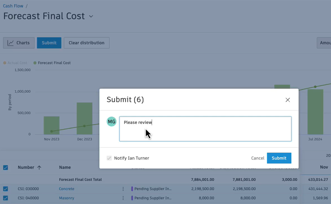

  5. Click Submit to send for review, write a message, and confirm by clicking Submit.
    Submit button for review with message

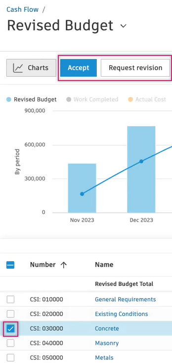

  2. Select the distribution items you want to accept or request revision for, then click Accept or Request revision.
    Accept and Request revision buttons for distribution items
