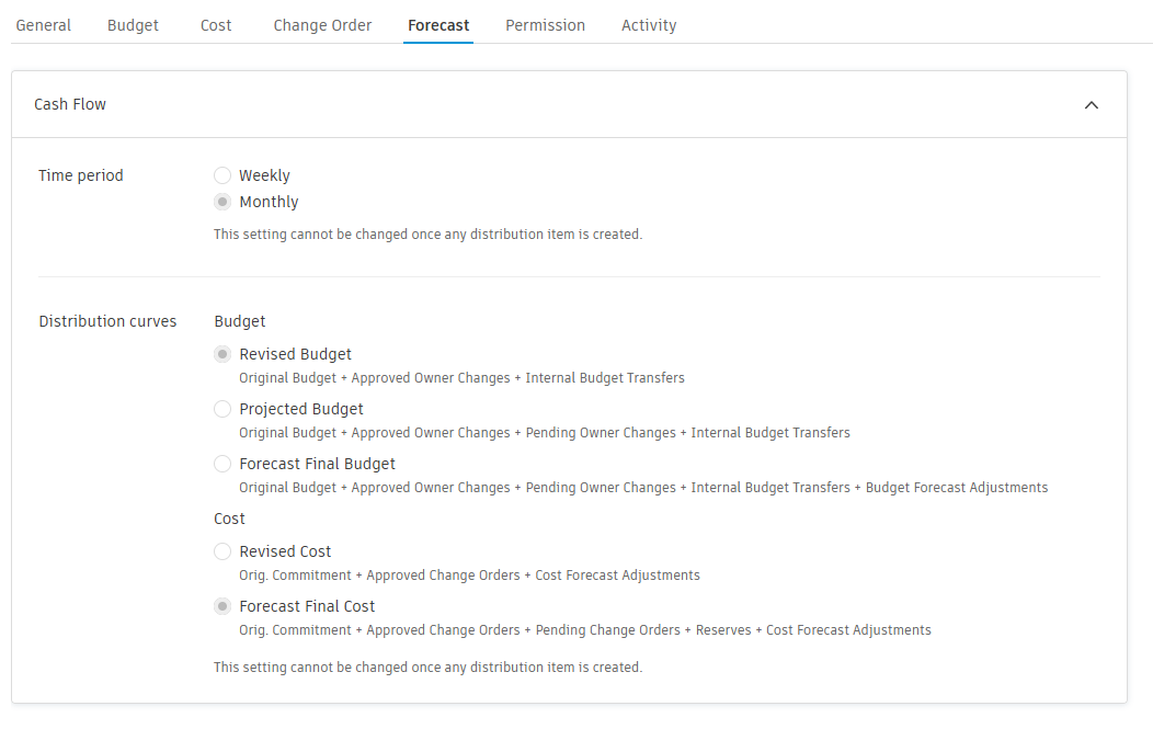

Cash Flow
Here project administrators can set up forecast distribution for the cash flow in the Forecast tab.
First, choose between weekly and monthly distribution.
Note: This setting can't be changed after the forecast distribution is created on any budget.
Distribution Curves
This section allows administrators to select what to include in the cash flow distribution. There are several options related to both the Budget and Cost.
For the Budget:
  • Revised Budget: This includes the Original Budget, Internal Budget Transfer, and Approved Owner Changes.
  • Projected Budget: This encompasses the same elements as the Revised Budget, in addition to Pending Owner Changes.
  • Forecast Final Budget: This includes all the elements in the Projected Budget, plus Budget Forecast Adjustments. This curve is visible when project administrator set the budget forecast setting.
For the Cost:
  • Revised Cost: This includes Commitments, Approved Change Orders, and Forecast Adjustments.
  • Forecast Final Cost: This includes all the elements in the Revised Cost, plus Reserves and Pending Change Orders.
Distribution curves settings panel showing budget and cost options for cash flow forecasting
Note: Once any distribution item has been created, these settings cannot be changed.
