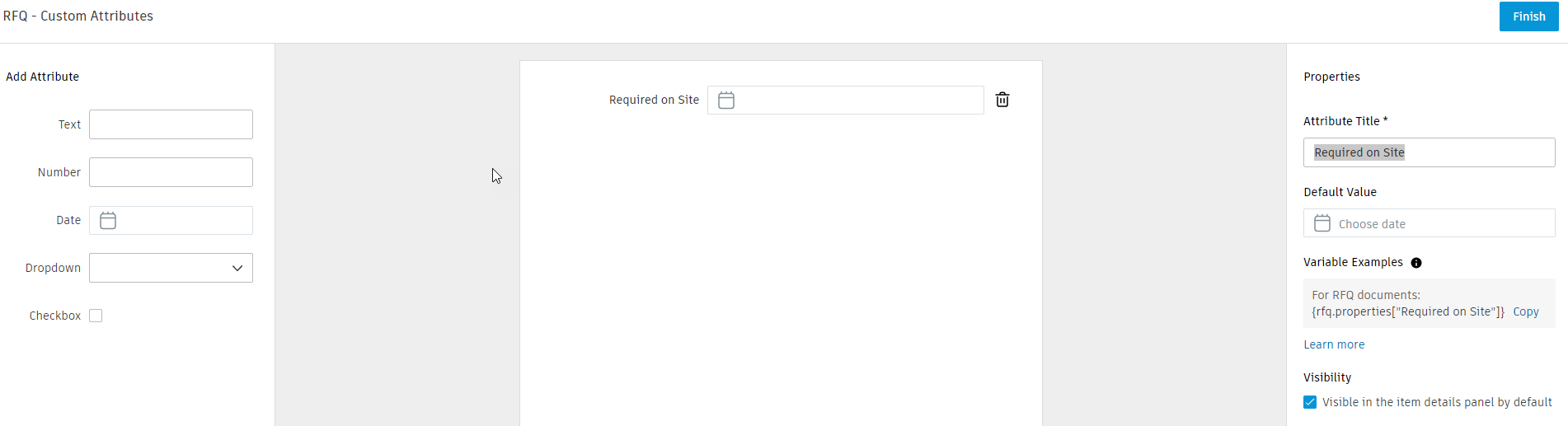

A date custom attribute for an RFQ titled "Required on Site" would be {rfq.properties["Required on Site"]} would return the date specified.
You can copy the variables from the custom attribute edit screen in Project Admin.
