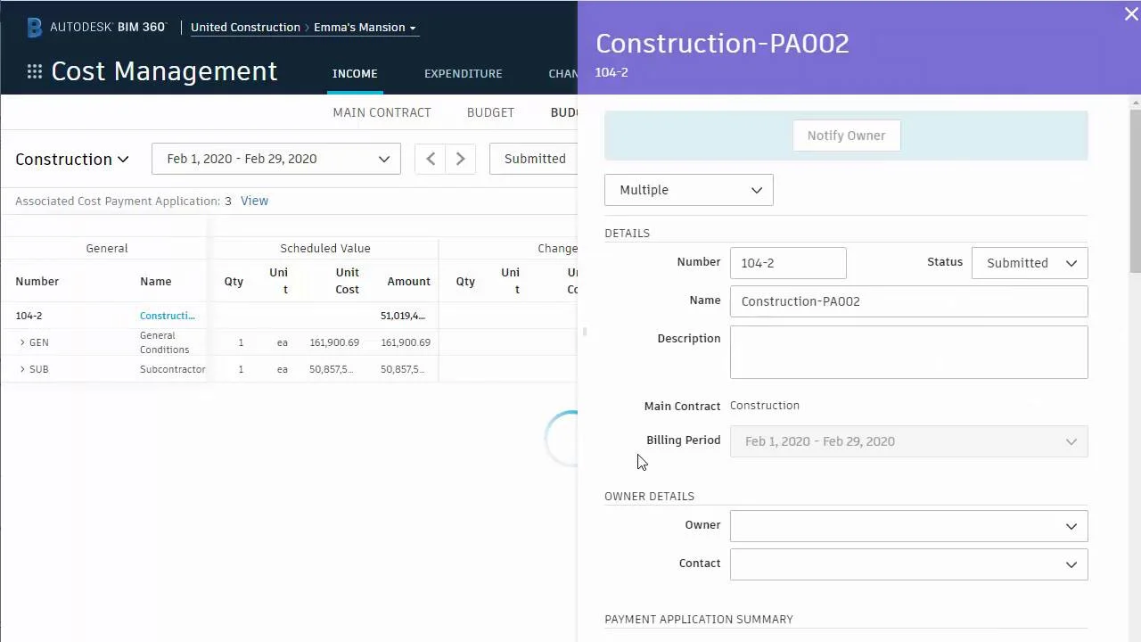

The following animation demonstrates the workflow.
