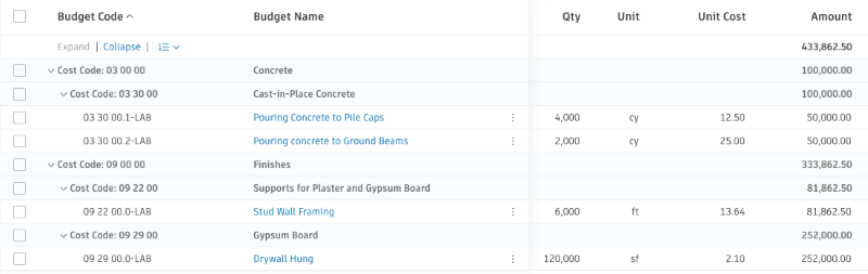

Create Performance Tracking Item from the Budget
Tracking items are created from a budget. To start working with the Performance Tracking workflow, you need to have a budget added with the budget code segments defined. Add unit, quantity, unit cost, and the amount of the budget you want to perform tracking on.
Tip: You can set your budget as time-related or item-related. If it is time-related, make sure you set a time-related unit (for example, hr).

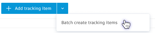

To add a tracking item:
  1. Select the Forecast tab in Cost Management.
  2. Switch to the Performance Tracking tab.
  3. Select Add tracking item or Batch create tracking items from the dropdown menu.
  4. Search by Budget Code and choose the budget or budgets that you want to track.
The selected budget is added as a tracking item with an automatically assigned instance, on which you can plan the input and output and track actuals to see how well your labor is performing.

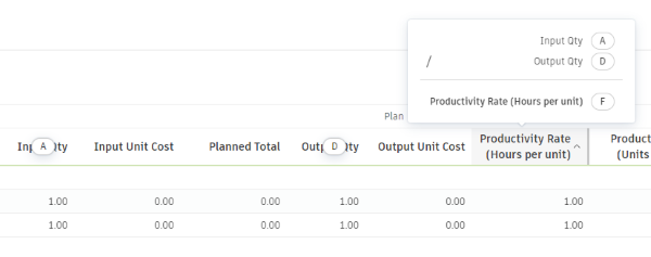

Tip: Understand the logic of the Performance Tracking table’s columns by hovering over their names.

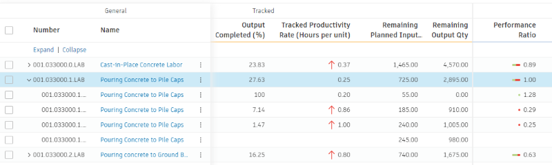

Monitor Performance Ratio
Every time you update a tracking item instance with current values, you can see the changes in the Performance Tracking table. The table allows you to monitor the relationship between planned and tracked performance in three views, which you can change according to the type of work:
While the first two are more detailed, the Performance Summary view shows the simplified data:
Tip: You can filter and group the items in the table and save those views for future use. You can also add or remove columns by using the icon.
Performance Ratio
You can see if your team on the jobsite is:
  • On track, when Productivity Rate (hours per unit) divided by Tracked Productivity Rate (hours per unit) is equal to 1. This is shown by the green dot on the instance in the Performance Ratio column.
  • Overperforming, when this ratio is greater to 1, which is indicated by the green dot.
  • Underperforming, when this ratio is lower than 1, which is shown by the red dot.
For example, the planned productivity rate is three hours per installation of one window. If the tracked productivity rate is two hours per window, the ratio is greater than 1 – your team is overperforming.
In the Performance Ratio column, you can also see the progress bar, which shows the performance of the tracking item. The color of the progress bar is calculated by the proportion of performance on the instances. Even if the progress bar shows 1.00, one of the instances may be overperforming, while others may be underperforming. You can dive into details to view the actual performance in each instance.
Tip: You can see the details panel by clicking the instance item in the Performance Tracking table. In the Tracked Input and Output section, you can see the relationship between those values and decide to make forecast adjustments if necessary.
