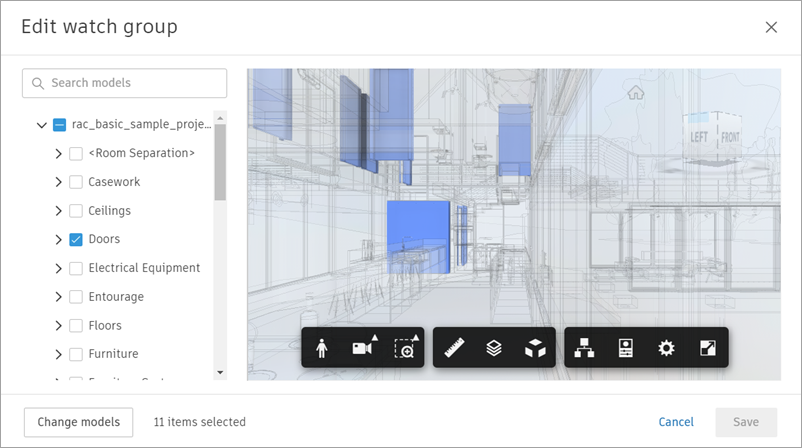

Use the dialog box to select the items you want to watch. You can select the whole model, or use the search box or expand the model tree to find specific items:
Tip: Use the viewer window and toolbar to explore the model and look at the items or areas you want to watch for changes. Click the item names or select the checkboxes to highlight items in the viewer.Click Next.

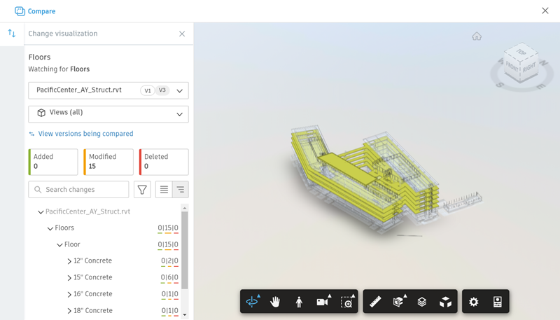

If there are changes for the items you added to the watch group, the changes are displayed in a tree structure in the Changes list:
Note: There may be no changes to view, for example if your team has not consumed the latest package containing a new model version, or if your work-in-progress model hasn't been shared, or is the same version as the shared model. In this case, the Change visualization interface is not displayed.Use the search box and filters in the Change visualization interface to refine the changes shown in the Changes list.

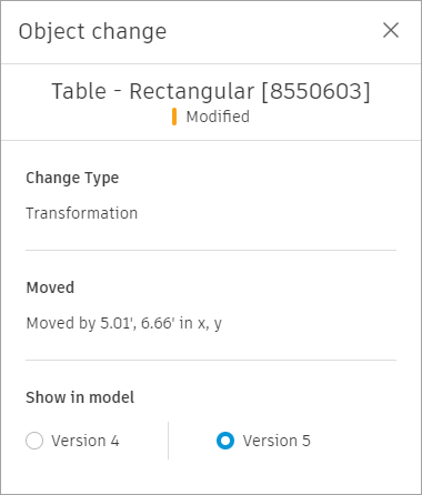

Click a change in the tree to view more information about the change in the right panel:
- At the bottom of the panel, use the buttons to toggle between the selected versions, and visualize the change in the model.

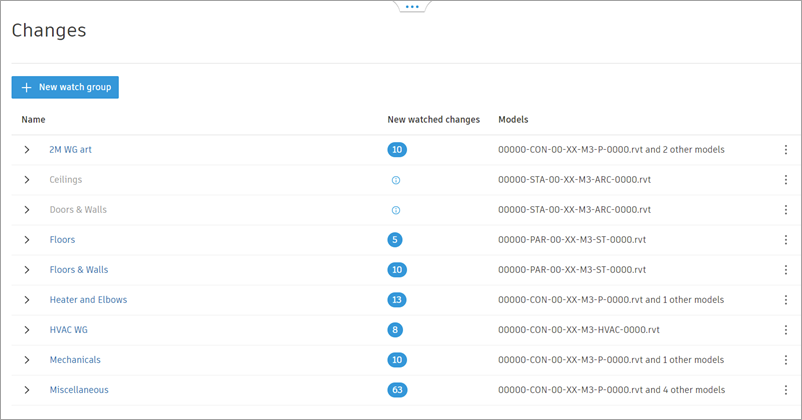

In Design Collaboration, click Changes.
A list of existing watch groups is displayed in the Changes dashboard.
Use the Changes dashboard to review the watch groups:
The number icon indicates the number of new changes for the watch group. Expand a watch group to view the models and items included, and to see the number of changes for those models or items.

Use the Change visualization interface to search, filter, and review the changes.
Click a change in the Changes list to display additional details about the change in the right panel.

- Click Change models and use the dialog box to add or remove models.
- Click Next.
- Use the Edit watch group items dialog box to change the selection of items included in the watch group.
- Click Save.
