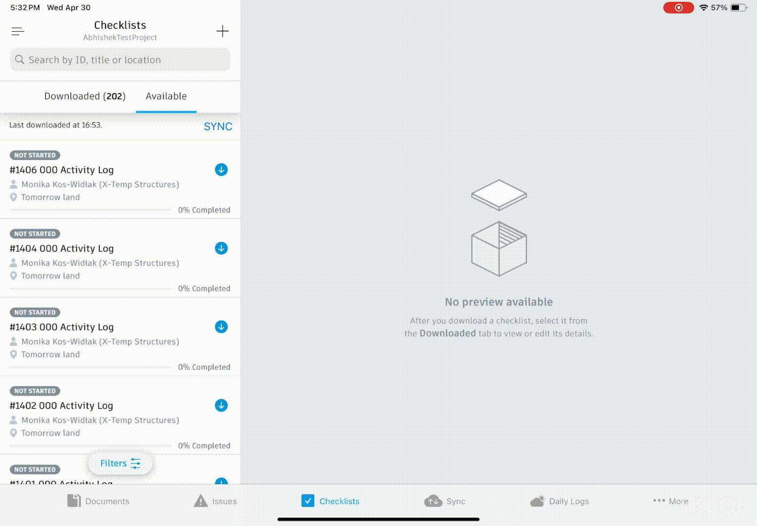

Download a Checklist
These instructions assume that you're downloading your checklist for the first time.
Tap
On the Available tab, click the download icon
next to the checklist that you want to download.
To automatically select all checklists at the same time:
- Tap the plus icon at the top right of the checklists list
> Select checklists
- Tap the Select all checkbox
- Tap the more menu
> Download checklists
Once a checklist has been downloaded, it appears on the Downloaded tab.

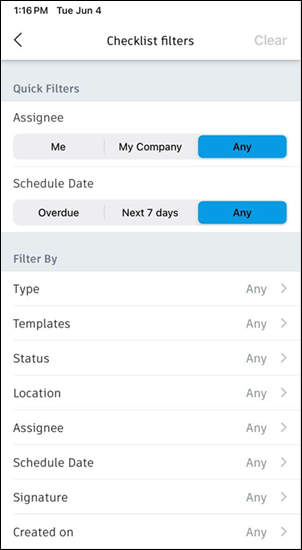

Complete and Filter Checklists
Tap Checklists
To filter your checklists, tap Filters
. The Filters panel is made up of two parts:
Quick Filters: You can quickly filter by Assignee (Me, My company, Any) or Schedule Date (Overdue, Next 7 days, Any)
Filters: You can filter by type, templates, status, location or sublocation, assignee, schedule date, signature, or creation date, tap Filters
Note:An assignee can be one of the following: member, role, or company. When you filter by assignee, the checklist is filtered by both the checklist assignee and section assignee.

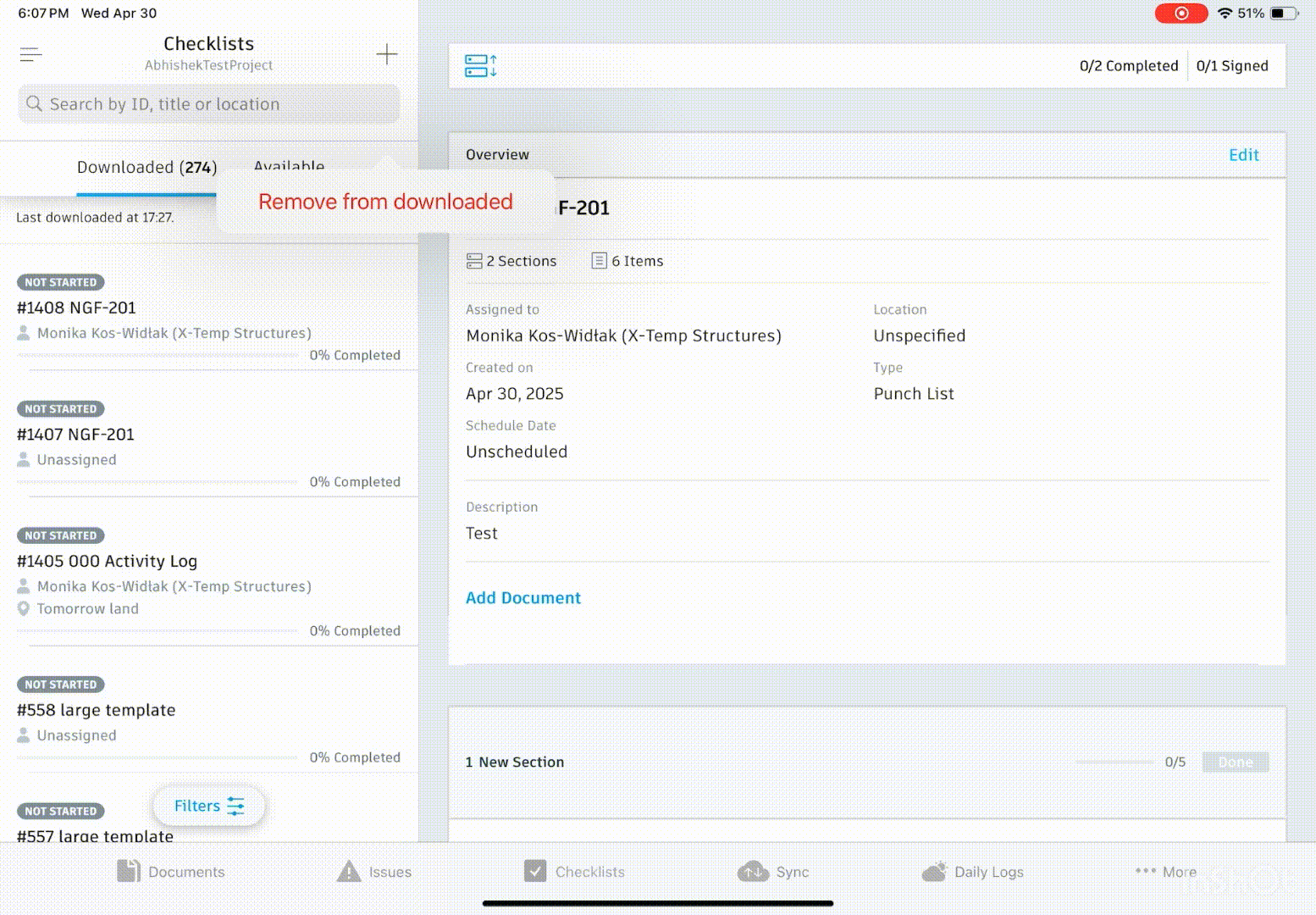

Remove a Checklist
You can remove a checklist from your local device while still keeping it in the project.
On the Downloaded tab, tap
> Select checklists.
Tap the checkbox next to the checklist that you'd like to remove.
Tap the more menu
> Remove from downloaded at the top right of the Checklists panel.
To remove all checklists:
Select the Select all checkbox
Tap the more menu
