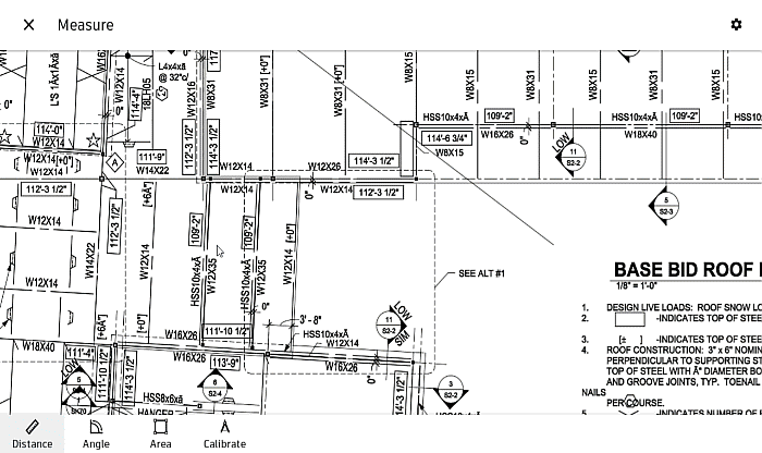

Measure the Distance Between Two Points
Measure the distance between two points in a 2D document or 3D model and view the XYZ differences between objects when measuring. A magnified view of your points helps you capture an exact location.
  1. Tap to open a document or model.
  2. Tap .
    Note: You need to use a known distance to calibrate documents or models that doesn't have calibration units specified. For more details, see Calibrate, below.
  3. Tap the start and end point of the distance you want to measure.
    Tip: A magnified view is displayed as you tap and hold a point on an object.

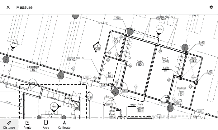

Measure the Angle
  2. Tap .
  3. Tap .
  4. Tap three points to measure an angle. The value of the measured angle is displayed.

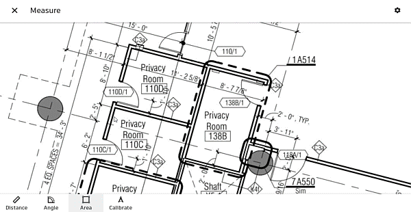

Measure the Area
  1. Tap to open a document.
  2. Tap .
  3. Tap .
  4. Tap three or more points to measure an area. The size of the measured area is displayed.
Note: Be sure to tap on the first point to close the area to measure.
