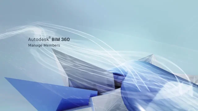

Watch this video to learn more about managing members:
