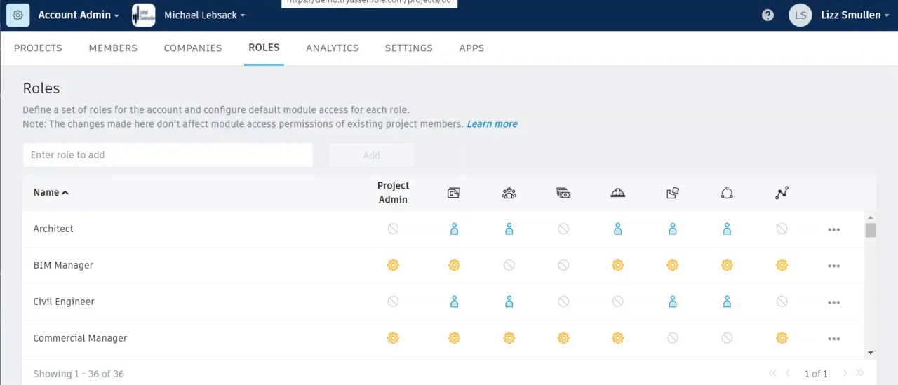

  1. Click the Module Selector Account Admin .
  2. Click the Roles tab.
  3. Start entering a role to add, then click the role in the displayed drop-down list.
    Tip: If the role you searched for doesn't exist, you are prompted to create the role. Click the "Create [role]" field in the drop-down list.
  4. Click Add.
    Tip: The new role is added at the top of the list; however, when you refresh the page, the role appears in the alphabetical order in the list.
  5. Click in the columns to change access to each module as needed.
The changes made by account administrators on the Roles tab don't affect module access permissions of existing project members. For a change to take effect, the edited role needs to be assigned to a new or existing project member.
After the role is created, you can quickly assign folder permissions using the role. Refer to the Folder Permissions topic to learn more.
Note: Account administrators can only configure module access associated with project-level roles. Account-level roles, such as executives and account administrators, can't be edited. For example, members with an Executive role can access the Executive Overview dashboard in the Insight module, and this access is not configurable.

Refer to the table below for a few examples of how permissions associated with a given role can control access to modules, or read the Issue Permissions topic to learn more about default permission levels by role for issues.
img: No access img: Project member access img: Administrator access
Project Defaults Account Defaults
Project Admin Insight Document Management Project Management Cost Management Design Collaboration Model Coordination Field Management Account Admin Insight/Executive Overview
