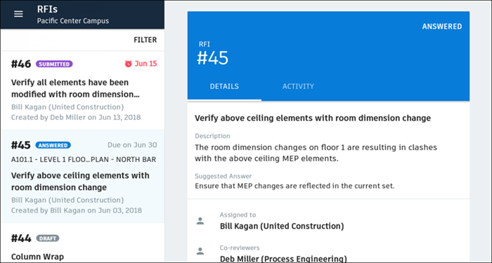

View RFIs
View the status and activity of RFIs and add comments and photos, at both the project and document level.
  1. Open a project, or a specific document or model within a project.
  2. At the project level, tap RFIs. In a document or model, tap RFIs.
  3. In the RFIs panel, tap an RFI to view its details.
    Tip: You can filter RFIs by status, assignee, or due date.
  4. Tap the Activity tab to view the RFI history and any comments or attachments.
