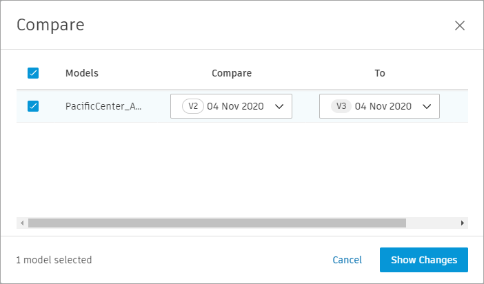

Tip: You can compare changes between consumed models, as well as work-in-progress designs and the latest package shared by your team.Click the Compare button at the top-right of the page to open the Compare dialog box:
Note: If there are no changes or there is only one version of the selected model or document, the Compare button is grayed out.Use the dialog box to select which models or documents you want to compare.
Use the drop-down lists to select which versions of the model or document you want to compare.
Click Show changes.
Use the Change visualization interface to review the changes.
