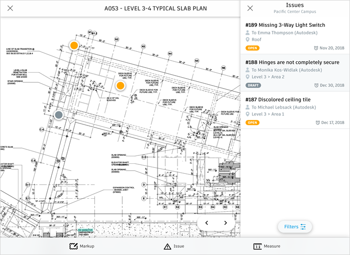

View Document-level Issues
View issues associated with a 2D document or 3D model.
- Tap to open a 2D document or 3D model.
- Tap
Issues.
The list displays the issue number and title, assignee, location, status, and due date if these fields have been specified.

Manage and Edit Document-level Issues
Manage and edit issues associated with a 2D document or 3D model.
Tap
Issues.
To filter the issues by type or subtype, status, location or sublocation, assignee, or due date, tap Filters
Tap an issue to edit it.
Tip: You can also tap a pin on the viewer to edit your issue.To change the issue status, tap
and select a new status.
To attach a photo, on the Details tab tap
. You can upload an existing photo or take a new one.
On the Details tab, update the issue details as desired.
Tap the Activity tab to view the activity associated with the selected issue.
