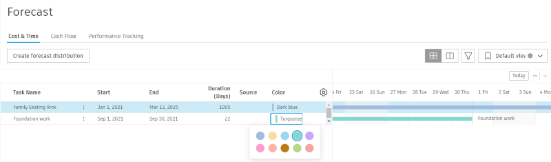

  1. Select the Forecast tab in Cost Management.
  2. Switch to the Cost & Time tab.
  3. Click Create Schedule Task.
  4. Enter a Task Name.
  5. Select a Start and End Date.
  6. Pick a color for the Gantt chart.
Forecast cost time overview

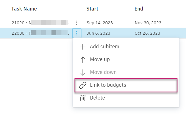

Once the task is created, use the More menu More menu icon in the task table to do any of the following:
  • Add subitems.
  • Move tasks up or down.
  • Link a task to a budget. Once a task and budget are linked, their color, start, and end dates become the same.

To link a schedule task to a budget item:
  1. Use the More menu More menu icon in the budget table.
  2. Click Link to budgets.
    Link to budgets menu option
