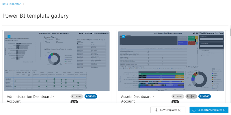

Project administrators and members with executive overview access can browse and download Power BI templates from the templates gallery available in Data Connector.
- Select the Insight module.
- Click
at the bottom of the left panel. - Click
You can now scroll through the gallery and select one or more templates to download.
The templates will download to your local downloads folder. Click a downloaded template to open it in Power BI desktop.
