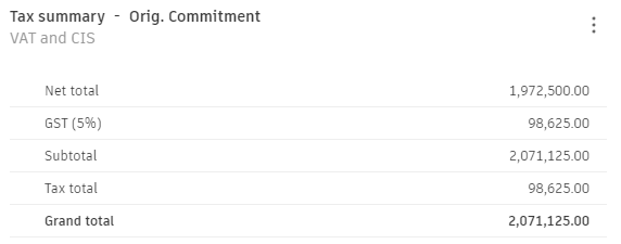

Using tax variables {#taxes} and {/taxes}, you can generate a list of the tax summary. For example, given the following tax summary in Cost Management:

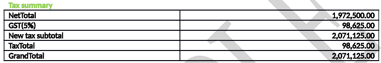

you could add the following to a document in a table:
{#taxes | toList}{name}{#rate}({rate*100}%){/} | {amount}{/taxes | toList}
to produce:
