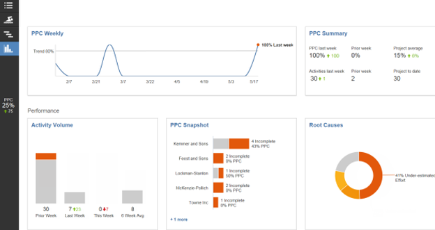

To monitor progress, the following reports are available.
  • PPC Weekly
    See how Planned Percent Complete (PPC) has changed during any weekly period. Select a custom time frame to focus in on a particular period of time.
  • PPC Summary
    Summarize PPC performance for a specific week, as well as for the periods prior to that week. Enter a date to set the time frame and select a primary filter to break out the PPC details in the table below.
  • Activity Volume
    View the status of activities over the past week, the current week or predictions for next week. Click a status from Incomplete, Complete, Committed, Backlog and Open to focus on those activities only.
  • PPC Snapshot
    View performance over a specific period of time. Choose the start and end dates or enter a custom time frame. Select a primary filter from Company, Location or WBS to define the vertical axis labels.
  • Root Causes
    See the most common causes for incomplete activities. Select a time frame and filter by Company, Location and more. You can expand the rows of the table to view more detailed information.
To Create a Report
  1. Click Reports and select a report type.
  2. Filter the report by Date, Company, Location or More.
    Note: You can hover over any data point on a report to see the value of that data point. You can also print a report or export it as a PDF file.
