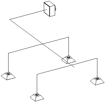

- Select any object in a connected system.
An example of a 1-line system.

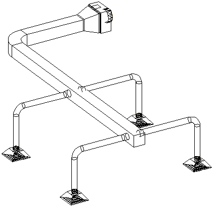

- When the calculations are complete, the system is resized in the drawing.
Example drawing converted to a sized 2-line duct system
