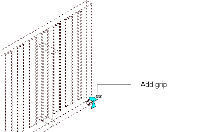

  1. Select a radiator.
  2. Click the (Add) grip on a radiator connector.
  3. In the Add Multi-view Parts dialog box, use the Part and Part Filter tabs to select a valve type and size. See Adding an MvPart.
  4. Press ENTER to add the valve to the connector.
  5. Press ENTER to end the command.
    Note: You can use a rotate grip to flip the valve 180 or 90 degrees. See Modifying a Radiator Valve.
