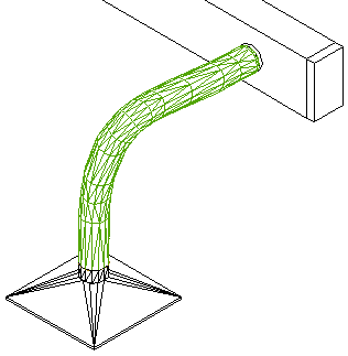

You can draw flexible duct runs. Flexible runs can be connected to rigid runs to create complete and accurate networks. Because flexible ducts are typically round in shape, the correct transition fitting is inserted when you connect to a duct segment of a different shape. You can specify a system for flexible duct components just as you can with rigid duct. You can also assign flexible and rigid components to the same system.
Flexible duct runs can be connected to equipment and MvParts.
You can draft a flexible duct run using different segment modes. Individual segments can be drafted as lines, arcs, or splines to create different configurations of flexible runs.
