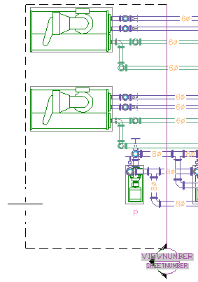

  2. On the Annotation tool palette, click the section mark tool.
    Note: Alternatively, use the Annotate ribbon tab and the Callouts panel to locate section mark tools.
  3. In the drawing, specify the points for the section line.
    The section line determines one side of the drawing boundary.
  4. At the location where you want to add the mark, press Enter.
  5. Specify the section extents. The parts of the drawing enclosed by the section extents will be included in the new section view drawing.

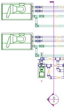

  6. In the Place Callout dialog box, for New Model Space View Name, specify a name to display in the title mark of the new section view.
  7. Verify that Generate Section/Elevation is selected.
  8. For Scale, specify the drawing scale for the detail view.
  9. Under Create in, click New View Drawing.

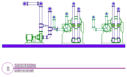

  16. In the general view drawing, specify the insertion point for the new section view.
    The new section view will not be inserted in the general view drawing; you are specifying its location in the new drawing. It is recommended that you specify a point away from the drawing geometry. You can use the zoom and pan commands to move to an open area in the drawing without closing the generate section view command.
    The new section view drawing is created, but not opened. The detail number and sheet number referenced in the section mark display as ?.
  17. Save and close the general view drawing.
  18. To open the new section view drawing, double-click it on the Views tab in Project Navigator.
  19. Zoom extents to display the drawing contents.
    The reference drawings are displayed in plan view. The section view is located at the point you specified in the general view drawing. The layers for each drawing object are preserved through the section view. The section number in the title mark will be resolved when you place the section view on a sheet.
