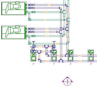

  1. Open the general view drawing to add the elevation mark.
  2. On the Annotation tool palette, click the elevation mark tool.
    Note: Alternatively, use the Annotate ribbon tab and the Callouts panel to locate elevation mark tools.
  3. In the drawing, specify the location for the elevation mark.
  4. Specify the viewing direction for the elevation mark.

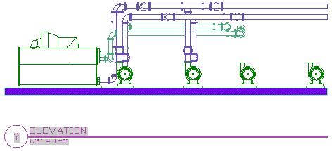

  15. In the drawing, specify corners of the elevation region. The parts of the drawing in the elevation region will be included in the new drawing.
  16. In the general view drawing, specify the insertion point for the new elevation view.
    The new view will not be inserted in the general view drawing; you are specifying its location in the new drawing. It is recommended that you specify a point away from the drawing geometry. You can use the zoom and pan commands to move to an open area in the drawing without closing the generate elevation view command.
  17. The new view drawing is created, but not opened. The detail number and sheet number referenced in the elevation mark display as ?.
  18. Save and close the general view drawing.
  19. To open the new elevation view drawing, double-click it on the Views tab in Project Navigator.
  20. Zoom extents to display the drawing contents.
    The reference drawings are displayed in plan view. The elevation view is located at the point you specified in the general view drawing. The layers for each drawing object are preserved through the elevation view. The elevation number in the title mark will be resolved when you place the elevation view on a sheet.
